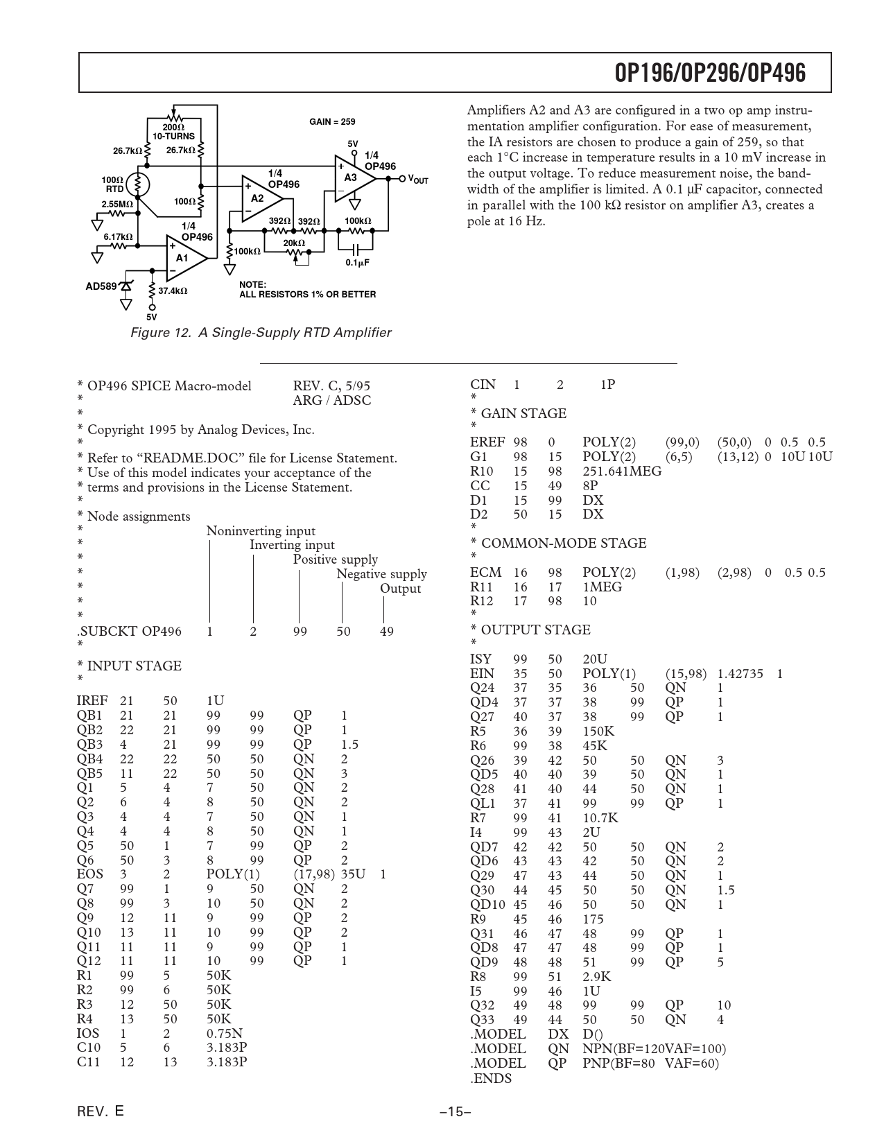

Amplifiers A2 and A3 are configured in a two op amp instru-
GAIN = 259 200
⍀ mentation amplifier configuration. For ease of measurement,
10-TURNS 5V
the IA resistors are chosen to produce a gain of 259, so that
26.7k
26.7k
1/4
each 1°C increase in temperature results in a 10 mV increase in
OP496 1/4 A3
the output voltage. To reduce measurement noise, the band-
V 100
OUT OP496 RTD
width of the amplifier is limited. A 0.1 µF capacitor, connected
A2 100 2.55M
⍀ ⍀ in parallel with the 100 kΩ resistor on amplifier A3, creates a
392
392
100k
⍀ pole at 16 Hz.
1/4 6.17k
OP496 20k
100k
A1 0.1
F AD589 NOTE: 37.4k
ALL RESISTORS 1% OR BETTER 5V
