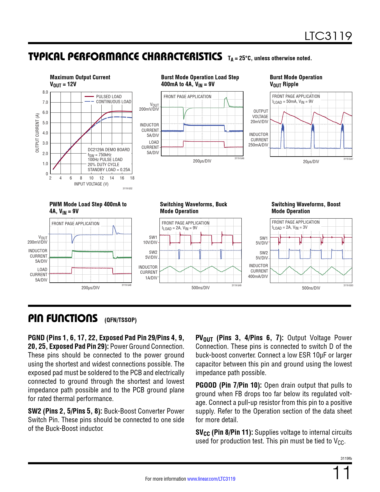

Typical perForMance characTerisTics TA = 25°C, unless otherwise noted. Maximum Output Current Burst Mode Operation Load Step Burst Mode Operation VOUT = 12V 400mA to 4A, VIN = 9V IN VOUT Ripple OUT
8.0 PULSED LOAD FRONT PAGE APPLICATION FRONT PAGE APPLICATION 7.0 CONTINUOUS LOAD I V LOAD = 50mA, VIN = 9V OUT 200mV/DIV OUTPUT 6.0 VOLTAGE 5.0 20mV/DIV INDUCTOR CURRENT 4.0 5A/DIV INDUCTOR 3.0 LOAD CURRENT CURRENT 250mA/DIV DC2129A DEMO BOARD OUTPUT CURRENT (A) 2.0 5A/DIV fSW = 750kHz 100Hz PULSE LOAD 200µs/DIV 3119 G46 20µs/DIV 3119 G47 1.0 20% DUTY CYCLE STANDBY LOAD = 0.25A 0 2 4 6 8 10 12 14 16 18 INPUT VOLTAGE (V) 3119 G52
PWM Mode Load Step 400mA to Switching Waveforms, Buck Switching Waveforms, Boost 4A, VIN = 9V IN Mode Operation Mode Operation
FRONT PAGE APPLICATION FRONT PAGE APPLICATION FRONT PAGE APPLICATION ILOAD = 2A, VIN = 9V ILOAD = 2A, VIN = 3V VOUT SW1 SW1 200mV/DIV 10V/DIV 5V/DIV INDUCTOR SW2 SW2 CURRENT 5V/DIV 5V/DIV 5A/DIV INDUCTOR INDUCTOR LOAD CURRENT CURRENT CURRENT 1A/DIV 400mA/DIV 5A/DIV 200µs/DIV 3119 G48 500ns/DIV 3119 G49 500ns/DIV 3119 G50
