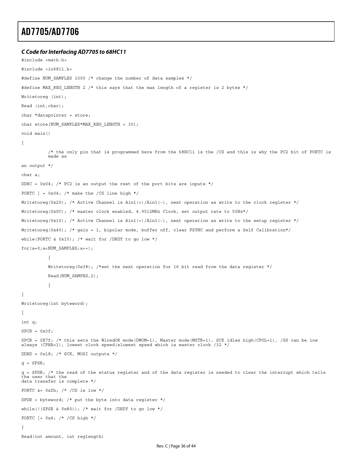

AD7705/AD7706 C Code for Interfacing AD7705 to 68HC11
#include <math.h> #include <io6811.h> #define NUM_SAMPLES 1000 /* change the number of data samples */ #define MAX_REG_LENGTH 2 /* this says that the max length of a register is 2 bytes */ Writetoreg (int); Read (int,char); char *datapointer = store; char store[NUM_SAMPLES*MAX_REG_LENGTH + 30]; void main() { /* the only pin that is programmed here from the 68HC11 is the /CS and this is why the PC2 bit of PORTC is made as an output */ char a; DDRC = 0x04; /* PC2 is an output the rest of the port bits are inputs */ PORTC | = 0x04; /* make the /CS line high */ Writetoreg(0x20); /* Active Channel is Ain1(+)/Ain1(−), next operation as write to the clock register */ Writetoreg(0x0C); /* master clock enabled, 4.9512MHz Clock, set output rate to 50Hz*/ Writetoreg(0x10); /* Active Channel is Ain1(+)/Ain1(−), next operation as write to the setup register */ Writetoreg(0x40); /* gain = 1, bipolar mode, buffer off, clear FSYNC and perform a Self Calibration*/ while(PORTC & 0x10); /* wait for /DRDY to go low */ for(a=0;a<NUM_SAMPLES;a++); { Writetoreg(0x38); /*set the next operation for 16 bit read from the data register */ Read(NUM_SAMPES,2); } } Writetoreg(int byteword); { int q; SPCR = 0x3f; SPCR = 0X7f; /* this sets the WiredOR mode(DWOM=1), Master mode(MSTR=1), SCK idles high(CPOL=1), /SS can be low always (CPHA=1), lowest clock speed(slowest speed which is master clock /32 */ DDRD = 0x18; /* SCK, MOSI outputs */ q = SPSR; q = SPDR; /* the read of the status register and of the data register is needed to clear the interrupt which tells the user that the data transfer is complete */ PORTC &= 0xfb; /* /CS is low */ SPDR = byteword; /* put the byte into data register */ while(!(SPSR & 0x80)); /* wait for /DRDY to go low */ PORTC |= 0x4; /* /CS high */ } Read(int amount, int reglength) Rev. C | Page 36 of 44 Document Outline FEATURES GENERAL DESCRIPTION FUNCTIONAL BLOCK DIAGRAM REVISION HISTORY PRODUCT HIGHLIGHTS SPECIFICATIONS TIMING CHARACTERISTICS ABSOLUTE MAXIMUM RATINGS ESD CAUTION PIN CONFIGURATIONS AND FUNCTION DESCRIPTIONS OUTPUT NOISE (5 V OPERATION) OUTPUT NOISE (3 V OPERATION) TYPICAL PERFORMANCE CHARACTERISTICS ON-CHIP REGISTERS COMMUNICATION REGISTER (RS2, RS1, RS0 = 0, 0, 0) SETUP REGISTER (RS2, RS1, RS0 = 0, 0, 1); POWER-ON/RESET STATUS: 01 HEXADECIMAL CLOCK REGISTER (RS2, RS1, RS0 = 0, 1, 0); POWER-ON/RESET STATUS: 05 HEXADECIMAL DATA REGISTER (RS2, RS1, RS0 = 0, 1, 1) TEST REGISTER (RS2, RS1, RS0 = 1, 0, 0); POWER-ON/RESET STATUS: 00 HEXADECIMAL ZERO-SCALE CALIBRATION REGISTER (RS2, RS1, RS0 = 1, 1, 0); POWER-ON/RESET STATUS: 1F4000 HEXADECIMAL FULL-SCALE CALIBRATION REGISTER (RS2, RS1, RS0 = 1, 1, 1); POWER-ON/RESET STATUS: 5761AB HEXADECIMAL Calibration Sequences CIRCUIT DESCRIPTION ANALOG INPUT Ranges Sample Rate BIPOLAR/UNIPOLAR INPUT REFERENCE INPUT DIGITAL FILTERING Filter Characteristics Postfiltering ANALOG FILTERING CALIBRATION Self-Calibration System Calibration Span and Offset Limits Power-Up and Calibration THEORY OF OPERATION CLOCKING AND OSCILLATOR CIRCUIT SYSTEM SYNCHRONIZATION RESET INPUT STANDBY MODE ACCURACY DRIFT CONSIDERATIONS POWER SUPPLIES SUPPLY CURRENT GROUNDING AND LAYOUT EVALUATING THE PERFORMANCE DIGITAL INTERFACE CONFIGURING THE AD7705/AD7706 MICROCOMPUTER/MICROPROCESSOR INTERFACING AD7705/AD7706-to-68HC11 Interface AD7705/AD7706-to-8051 Interface AD7705/AD7706-to-ADSP-2103/ADSP-2105 Interface CODE FOR SETTING UP THE AD7705/AD7706 C Code for Interfacing AD7705 to 68HC11 APPLICATIONS PRESSURE MEASUREMENT TEMPERATURE MEASUREMENT SMART TRANSMITTERS BATTERY MONITORING OUTLINE DIMENSIONS ORDERING GUIDE
