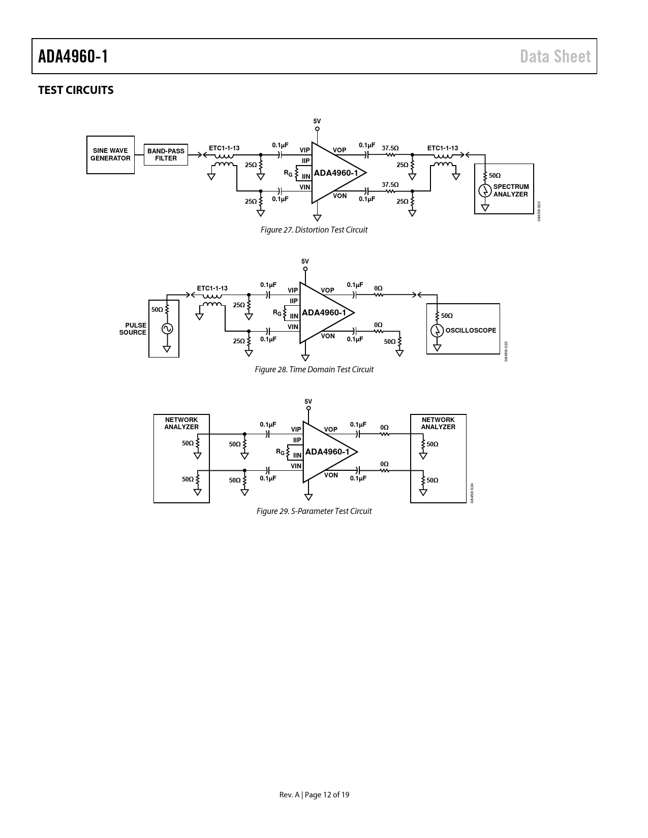

ADA4960-1. Data Sheet. TEST CIRCUITS. 0.1µF. ETC1-1-13. SINE WAVE. BAND-PASS. VIP. VOP. 37.5Ω. GENERATOR. FILTER. IIP. 25Ω. IIN. 50Ω. VIN. SPECTRUM. VON
ADA4960-1 Data Sheet TEST CIRCUITS 0.1µF ETC1-1-13 SINE WAVE BAND-PASS VIP VOP 37.5Ω GENERATOR FILTER IIP 25Ω IIN 50Ω VIN SPECTRUM VON

ADA4960-1 Data Sheet TEST CIRCUITS 5V 0.1µF 0.1µF ETC1-1-13 SINE WAVE BAND-PASS VIP VOP 37.5Ω ETC1-1-13 GENERATOR FILTER IIP 25Ω 25Ω RG ADA4960-1 IIN 50Ω VIN 37.5Ω SPECTRUM VON ANALYZER 25Ω 0.1µF 0.1µF 25Ω
022 08458- Figure 27. Distortion Test Circuit
5V 0.1µF 0.1µF ETC1-1-13 VIP VOP 0Ω IIP 25Ω 50Ω RG ADA4960-1 IIN 50Ω PULSE VIN 0Ω SOURCE OSCILLOSCOPE VON 25Ω 0.1µF 0.1µF 50Ω
023 08458- Figure 28. Time Domain Test Circuit
5V NETWORK NETWORK ANALYZER 0.1µF 0.1µF VIP VOP 0Ω ANALYZER IIP 50Ω 50Ω 50Ω RG ADA4960-1 IIN VIN 0Ω VON 50Ω 50Ω 0.1µF 0.1µF 50Ω
024 08458- Figure 29. S-Parameter Test Circuit Rev. A | Page 12 of 19 Document Outline Features Applications Functional Block Diagram General Description Revision History Specifications Absolute Maximum Ratings Thermal Resistance Maximum Power Dissipation ESD Caution Pin Configuration and Function Descriptions Typical Performance Characteristics Test Circuits Circuit Description Basic Structure Applications Information Basic Connections Input and Output Interfacing Gain Adjust Bandwidth Extension ADC Interfacing Line Driver Applications Overdrive and Recovery Layout, Grounding, and Bypassing Outline Dimensions Ordering Guide
