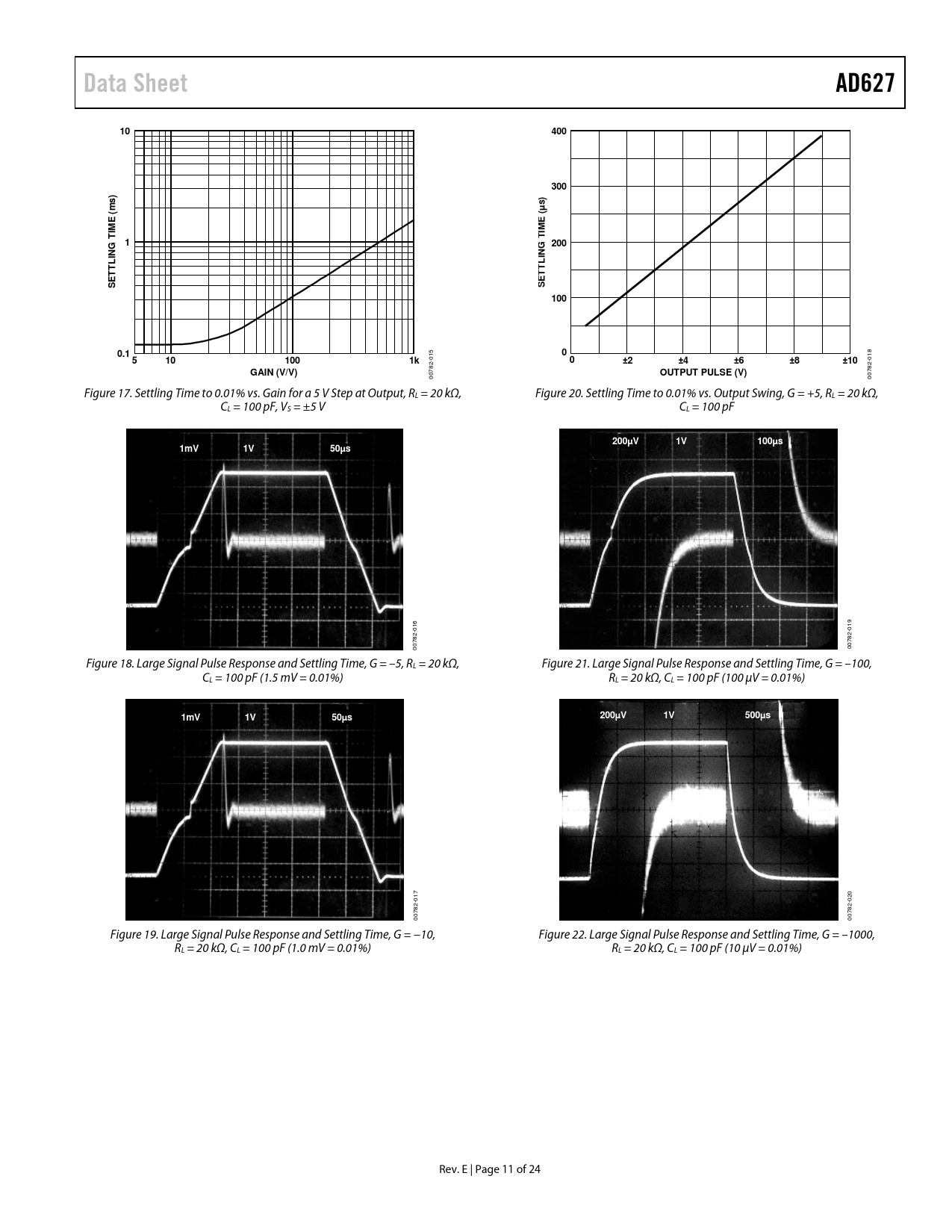

Data Sheet AD627 10 400 300 ) s ) s m µ ( ( E E G TIM 1 200 G TIM TTLIN TTLIN E E S S 100 0.1 0 5 10 100 1k
015
0 ±2 ±4 ±6 ±8 ±10
018
GAIN (V/V) OUTPUT PULSE (V)
00782- 00782- Figure 17. Settling Time to 0.01% vs. Gain for a 5 V Step at Output, RL = 20 kΩ, Figure 20. Settling Time to 0.01% vs. Output Swing, G = +5, RL = 20 kΩ, CL = 100 pF, VS = ±5 V CL = 100 pF
200µV 1V 100µs 1mV 1V 50µs
016 019 00782- 00782- Figure 18. Large Signal Pulse Response and Settling Time, G = –5, RL = 20 kΩ, Figure 21. Large Signal Pulse Response and Settling Time, G = –100, CL = 100 pF (1.5 mV = 0.01%) RL = 20 kΩ, CL = 100 pF (100 µV = 0.01%)
1mV 1V 50µs 200µV 1V 500µs
017 020 00782- 00782- Figure 19. Large Signal Pulse Response and Settling Time, G = −10, Figure 22. Large Signal Pulse Response and Settling Time, G = –1000, RL = 20 kΩ, CL = 100 pF (1.0 mV = 0.01%) RL = 20 kΩ, CL = 100 pF (10 µV = 0.01%) Rev. E | Page 11 of 24 Document Outline Features Applications Functional Block Diagram General Description Table of Contents Revision History Specifications Single Supply Dual Supply Dual and Single Supplies Absolute Maximum Ratings ESD Caution Pin Configurations and Function Descriptions Typical Performance Characteristics Theory of Operation Using the AD627 Basic Connections Setting the Gain Reference Terminal Input Range Limitations in Single-Supply Applications Output Buffering Input and Output Offset Errors Make vs. Buy: A Typical Application Error Budget Errors Due to AC CMRR Ground Returns for Input Bias Currents Layout and Grounding Input Protection RF Interference Applications Circuits Classic Bridge Circuit 4 mA to 20 mA Single-Supply Receiver Thermocouple Amplifier Outline Dimensions Ordering Guide
