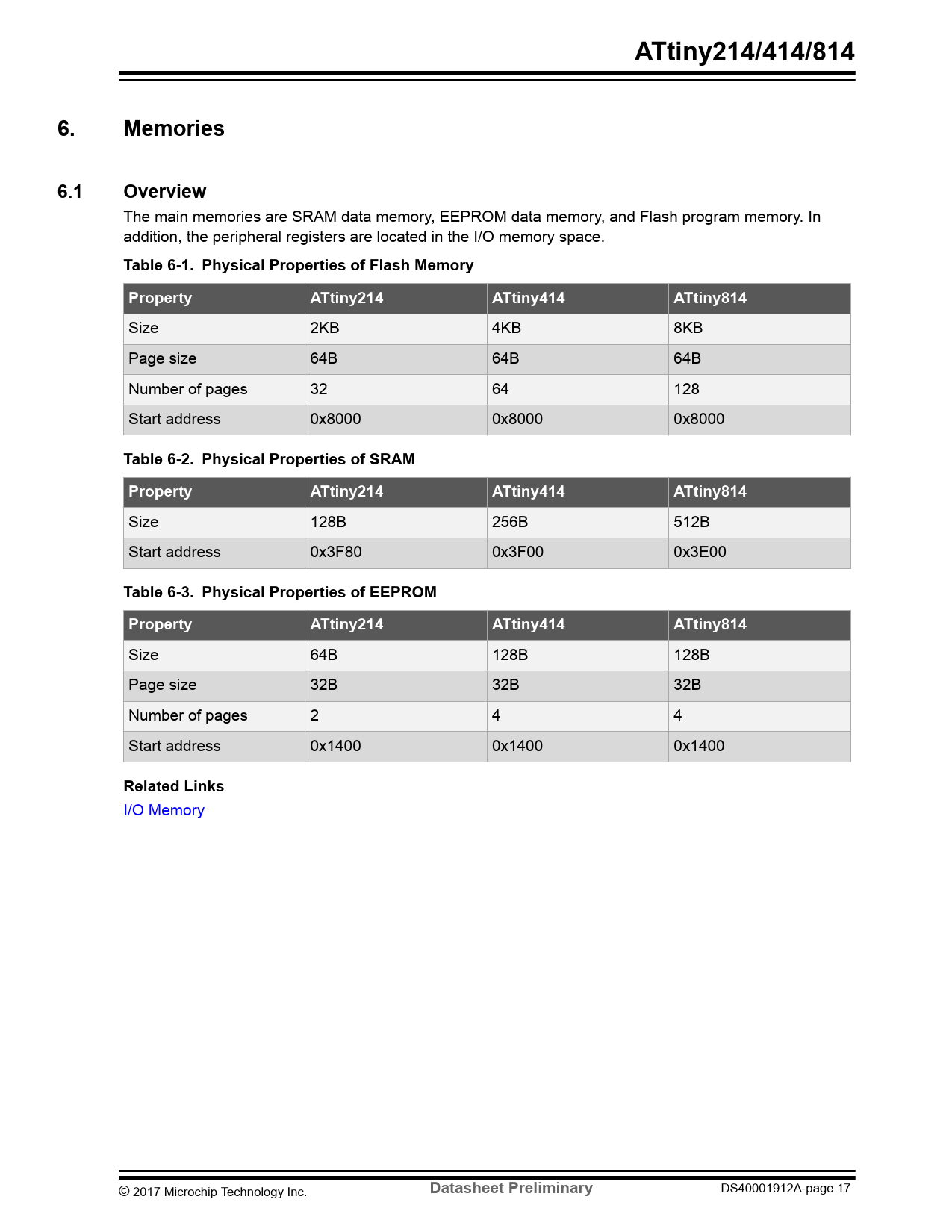

ATtiny214/414/814 6. Memories 6.1 Overview
The main memories are SRAM data memory, EEPROM data memory, and Flash program memory. In addition, the peripheral registers are located in the I/O memory space.
Table 6-1. Physical Properties of Flash Memory Property ATtiny214 ATtiny414 ATtiny814
Size 2KB 4KB 8KB Page size 64B 64B 64B Number of pages 32 64 128 Start address 0x8000 0x8000 0x8000
Table 6-2. Physical Properties of SRAM Property ATtiny214 ATtiny414 ATtiny814
Size 128B 256B 512B Start address 0x3F80 0x3F00 0x3E00
Table 6-3. Physical Properties of EEPROM Property ATtiny214 ATtiny414 ATtiny814
Size 64B 128B 128B Page size 32B 32B 32B Number of pages 2 4 4 Start address 0x1400 0x1400 0x1400
Related Links
I/O Memory © 2017 Microchip Technology Inc.
Datasheet Preliminary
