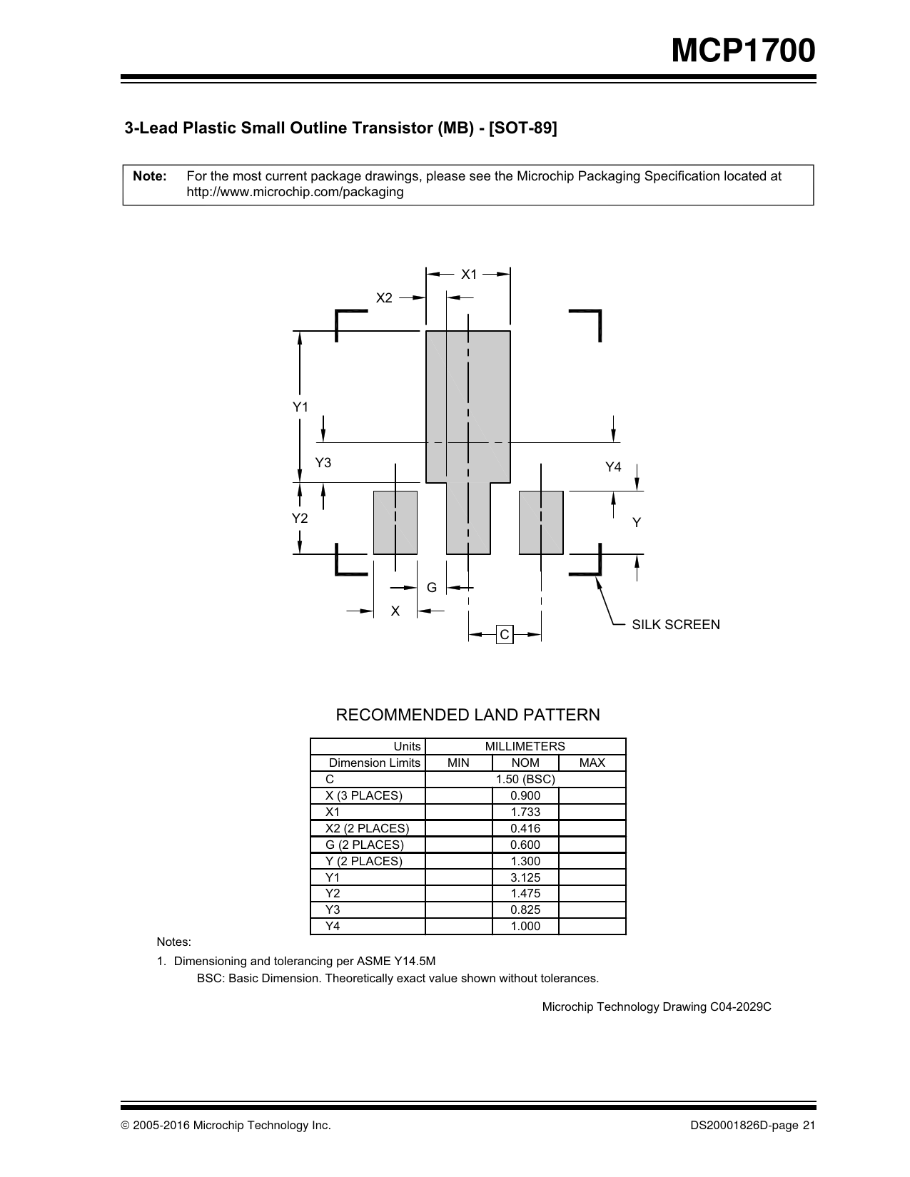

3-Lead Plastic Small Outline Transistor (MB) -[SOT-89]
Note: For the most current package drawings, please see the Microchip Packaging Specification located at
http://www.microchip.com/packaging X1
X2 Y1 Y3 Y4 Y2 Y G
X
SILK SCREEN C RECOMMENDED LAND PATTERN
Units
Dimension Limits
C
X (3 PLACES)
X1
X2 (2 PLACES)
G (2 PLACES)
Y (2 PLACES)
Y1
Y2
Y3
Y4 MIN MILLIMETERS
NOM
1.50 (BSC)
0.900
1.733
0.416
0.600
1.300
3.125
1.475
0.825
1.000 MAX Notes:
