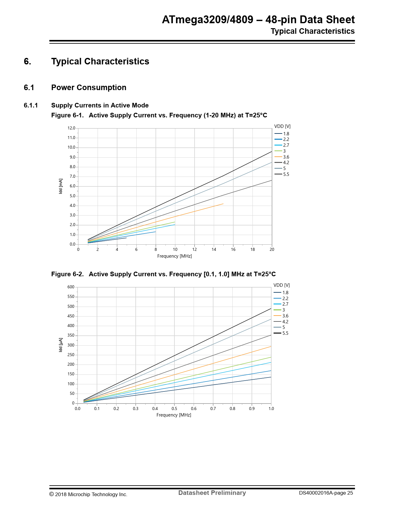

ATmega3209/4809 – 48-pin Data Sheet Typical Characteristics 6. Typical Characteristics 6.1 Power Consumption 6.1.1 Supply Currents in Active Mode Figure 6-1.  Active Supply Current vs. Frequency (1-20 MHz) at T=25°C
12.0 VDD [V] 1.8 11.0 2.2 10.0 2.7 3 9.0 3.6 4.2 8.0 5 7.0 5.5 6.0 5.0 4.0 3.0 2.0 1.0 0.0 0 2 4 6 8 10 12 14 16 18 20 Frequency [MHz]
Figure 6-2.  Active Supply Current vs. Frequency [0.1, 1.0] MHz at T=25°C
600 VDD [V] 1.8 550 2.2 500 2.7 3 450 3.6 4.2 400 5 350 5.5 300 250 200 150 100 50 00.0 0.1 0.2 0.3 0.4 0.5 0.6 0.7 0.8 0.9 1.0 Frequency [MHz] © 2018 Microchip Technology Inc.
