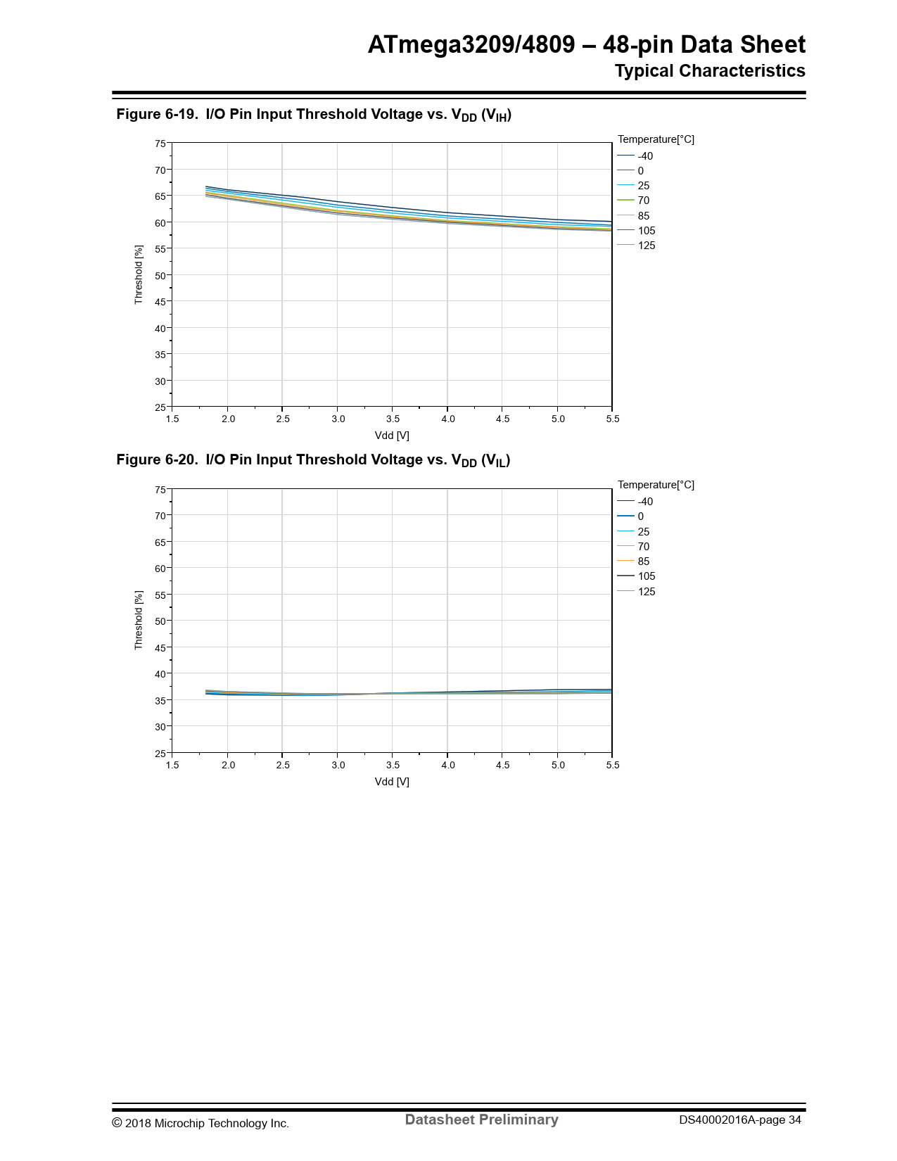

ATmega3209/4809 – 48-pin Data Sheet. Typical Characteristics. Figure 6-19. I/O Pin Input Threshold Voltage vs. VDD (VIH)
ATmega3209/4809 – 48-pin Data Sheet Typical Characteristics Figure 6-19. I/O Pin Input Threshold Voltage vs VDD (VIH)

ATmega3209/4809 – 48-pin Data Sheet Typical Characteristics Figure 6-19. I/O Pin Input Threshold Voltage vs. VDD (VIH)
75 Temperature[°C] -40 70 0 25 65 70 85 60 105 ] 55 125 % d [ 50 Threshol 45 40 35 30 25 1.5 2.0 2.5 3.0 3.5 4.0 4.5 5.0 5.5 Vdd [V]
Figure 6-20. I/O Pin Input Threshold Voltage vs. VDD (VIL)
75 Temperature[°C] -40 70 0 25 65 70 85 60 105 ] 55 125 % d [ 50 Threshol 45 40 35 30 25 1.5 2.0 2.5 3.0 3.5 4.0 4.5 5.0 5.5 Vdd [V] © 2018 Microchip Technology Inc.
