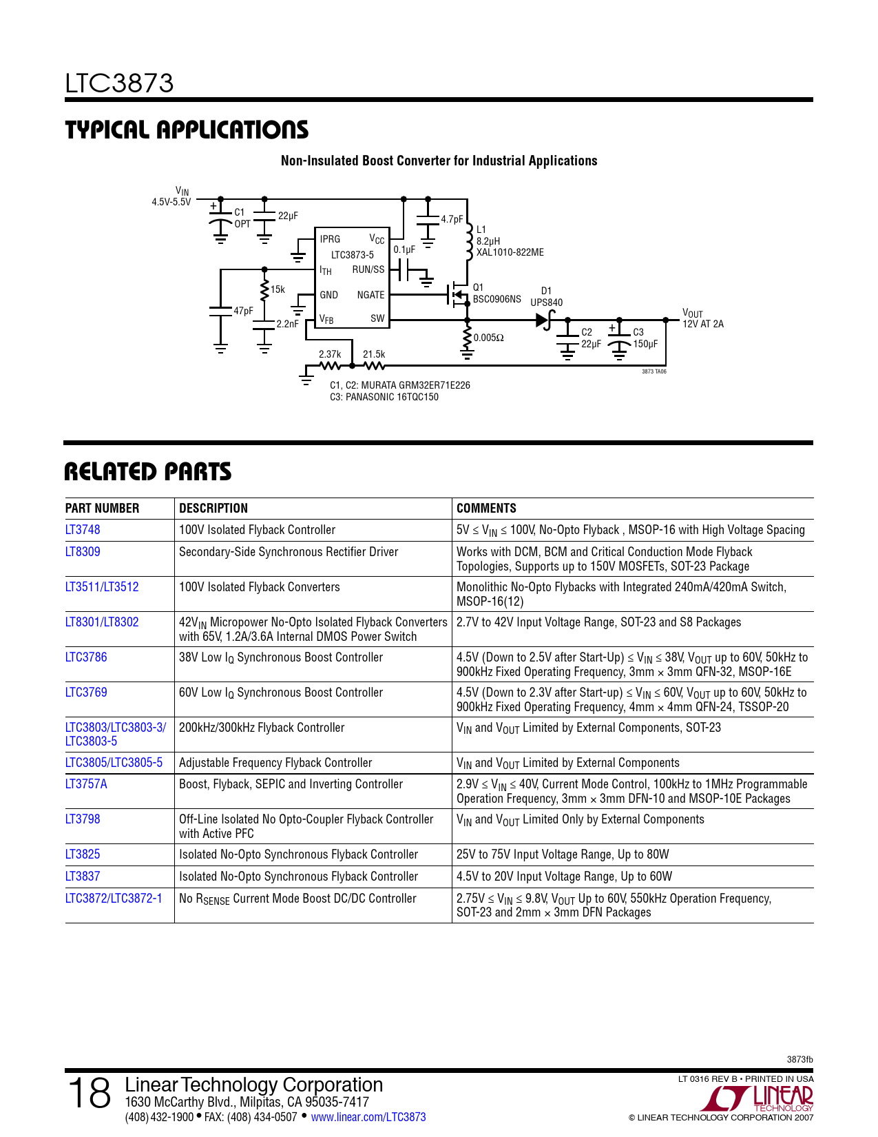

TYPICAL APPLICATIONS Non-Insulated Boost Converter for Industrial Applications
VIN 4.5V-5.5V + C1 22µF 4.7pF OPT L1 IPRG VCC 8.2µH LTC3873-5 0.1µF XAL1010-822ME ITH RUN/SS 15k Q1 GND D1 NGATE BSC0906NS UPS840 47pF V VOUT FB 2.2nF SW 12V AT 2A C2 + C3 0.005Ω 22µF 150µF 2.37k 21.5k 3873 TA06 C1, C2: MURATA GRM32ER71E226 C3: PANASONIC 16TQC150
