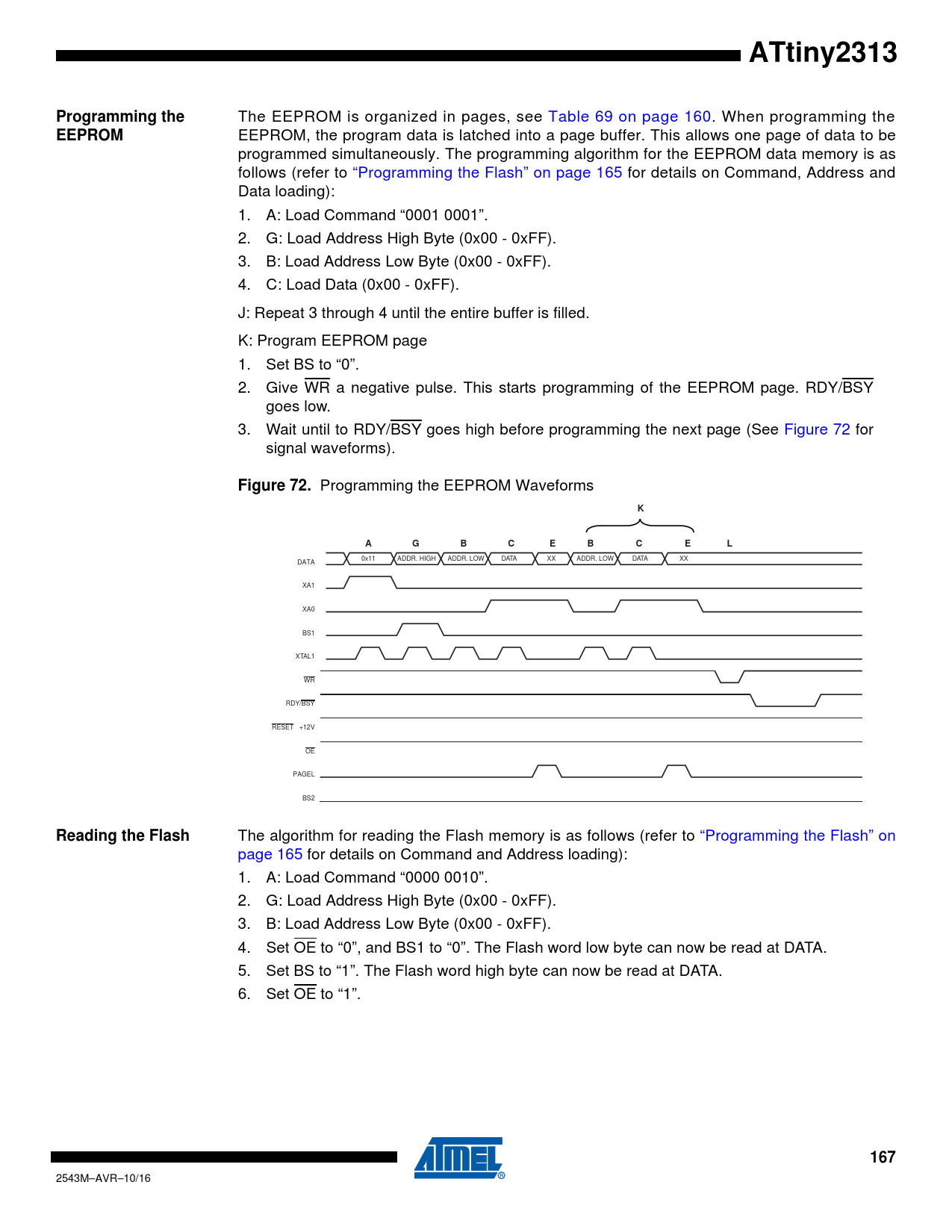

ATtiny2313 Programming the
The EEPROM is organized in pages, see Table 69 on page 160. When programming the
EEPROM
EEPROM, the program data is latched into a page buffer. This allows one page of data to be programmed simultaneously. The programming algorithm for the EEPROM data memory is as follows (refer to “Programming the Flash” on page 165 for details on Command, Address and Data loading): 1. A: Load Command “0001 0001”. 2. G: Load Address High Byte (0x00 - 0xFF). 3. B: Load Address Low Byte (0x00 - 0xFF). 4. C: Load Data (0x00 - 0xFF). J: Repeat 3 through 4 until the entire buffer is filled. K: Program EEPROM page 1. Set BS to “0”. 2. Give WR a negative pulse. This starts programming of the EEPROM page. RDY/BSY goes low. 3. Wait until to RDY/BSY goes high before programming the next page (See Figure 72 for signal waveforms).
Figure 72.
Programming the EEPROM Waveforms
K A G B C E B C E L
0x11 ADDR. HIGH ADDR. LOW DATA XX ADDR. LOW DATA XX DATA XA1 XA0 BS1 XTAL1 WR RDY/BSY RESET +12V OE PAGEL BS2
Reading the Flash
The algorithm for reading the Flash memory is as follows (refer to “Programming the Flash” on page 165 for details on Command and Address loading): 1. A: Load Command “0000 0010”. 2. G: Load Address High Byte (0x00 - 0xFF). 3. B: Load Address Low Byte (0x00 - 0xFF). 4. Set OE to “0”, and BS1 to “0”. The Flash word low byte can now be read at DATA. 5. Set BS to “1”. The Flash word high byte can now be read at DATA. 6. Set OE to “1”.
