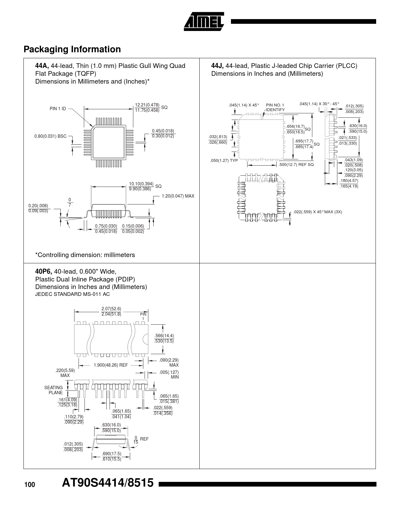

Packaging Information 44A,
44-lead, Thin (1.0 mm) Plastic Gull Wing Quad
44J,
44-lead, Plastic J-leaded Chip Carrier (PLCC) Flat Package (TQFP) Dimensions in Inches and (Millimeters) Dimensions in Millimeters and (Inches)* 12.21(0.478) .045(1.14) X 45° PIN NO. 1 .045(1.14) X 30° - 45° SQ .012(.305) PIN 1 ID 11.75(0.458) IDENTIFY .008(.203) .656(16.7) .630(16.0) 0.45(0.018) SQ .650(16.5) .590(15.0) 0.80(0.031) BSC 0.30(0.012) .032(.813) .021(.533) .026(.660) .695(17.7) .013(.330) SQ .685(17.4) .050(1.27) TYP .043(1.09) .500(12.7) REF SQ .020(.508) .120(3.05) .090(2.29) .180(4.57) 10.10(0.394) SQ .165(4.19) 9.90(0.386) 1.20(0.047) MAX 0 0.20(.008) 7 0.09(.003) .022(.559) X 45° MAX (3X) 0.75(0.030) 0.15(0.006) 0.45(0.018) 0.05(0.002) *Controlling dimension: millimeters
40P6,
40-lead, 0.600" Wide, Plastic Dual Inline Package (PDIP) Dimensions in Inches and (Millimeters) JEDEC STANDARD MS-011 AC 2.07(52.6) 2.04(51.8) PIN 1 .566(14.4) .530(13.5) .090(2.29) 1.900(48.26) REF MAX .220(5.59) .005(.127) MAX MIN SEATING PLANE .065(1.65) .161(4.09) .015(.381) .125(3.18) .022(.559) .065(1.65) .014(.356) .110(2.79) .041(1.04) .090(2.29) .630(16.0) .590(15.0) 0 REF 15 .012(.305) .008(.203) .690(17.5) .610(15.5)
