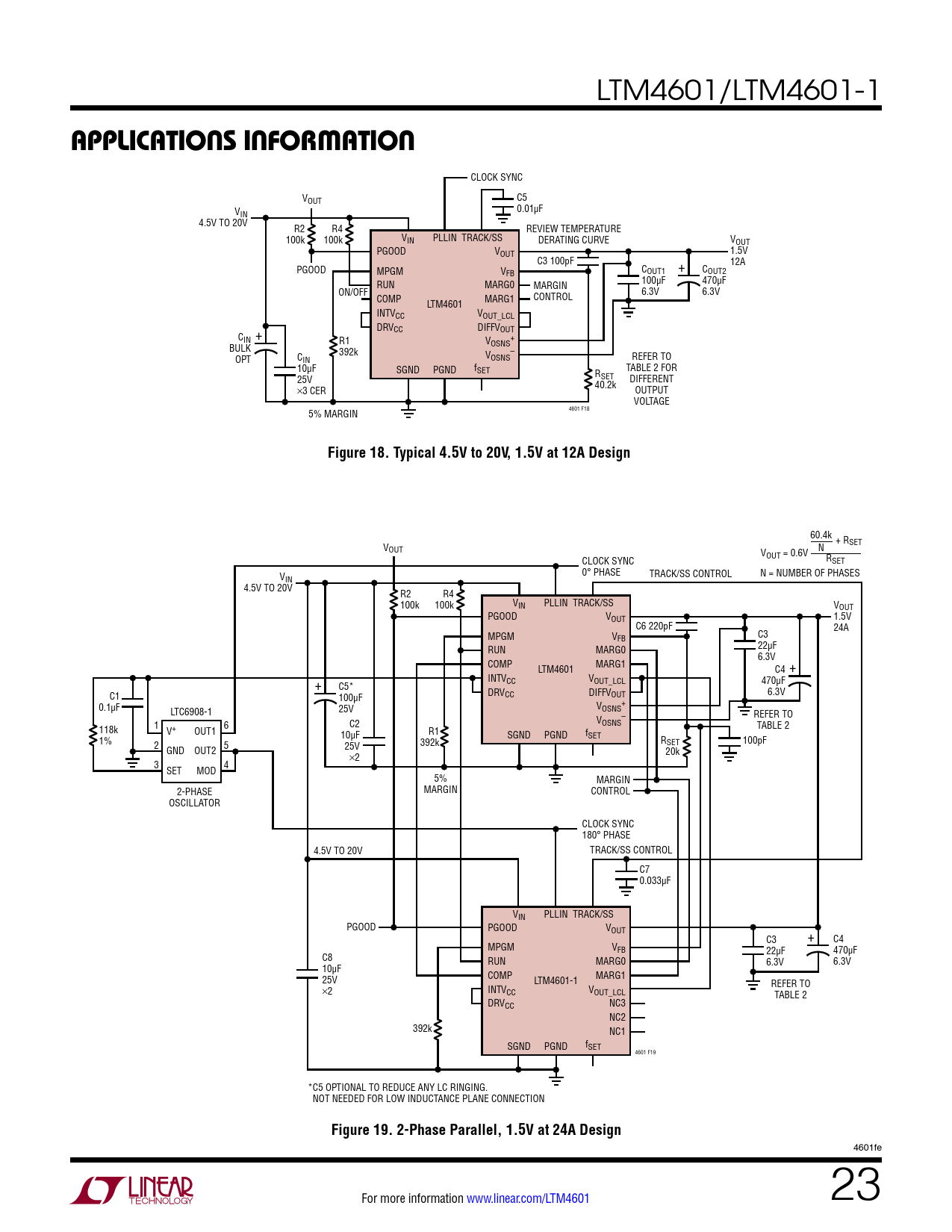

applicaTions inForMaTion
CLOCK SYNC V C5 OUT 0.01µF VIN 4.5V TO 20V R2 R4 REVIEW TEMPERATURE 100k 100k VIN PLLIN TRACK/SS DERATING CURVE VOUT PGOOD VOUT 1.5V C3 100pF 12A PGOOD MPGM V + FB COUT1 COUT2 RUN MARG0 100µF 470µF MARGIN ON/OFF 6.3V 6.3V COMP MARG1 CONTROL LTM4601 INTVCC VOUT_LCL DRVCC DIFFVOUT CIN + R1 V + OSNS BULK 392k V – OSNS REFER TO OPT CIN 10µF SGND PGND f TABLE 2 FOR SET RSET 25V DIFFERENT 40.2k ×3 CER OUTPUT VOLTAGE 4601 F18 5% MARGIN
Figure 18. Typical 4.5V to 20V, 1.5V at 12A Design
60.4k + R V SET OUT N V CLOCK SYNC OUT = 0.6V RSET 0° PHASE TRACK/SS CONTROL V N = NUMBER OF PHASES IN 4.5V TO 20V R2 R4 VIN PLLIN TRACK/SS 100k 100k VOUT PGOOD VOUT 1.5V C6 220pF 24A MPGM VFB C3 RUN MARG0 22µF 6.3V COMP MARG1 LTM4601 C4 + INTVCC VOUT_LCL 470µF + C5* DRVCC DIFFVOUT 6.3V C1 100µF 0.1µF V + 25V OSNS LTC6908-1 V – REFER TO 1 6 C2 OSNS 118k V+ OUT1 R1 TABLE 2 10µF SGND PGND fSET 1% 392k RSET 2 5 25V 100pF GND OUT2 20k ×2 3 SET 4 MOD 5% MARGIN 2-PHASE MARGIN CONTROL OSCILLATOR CLOCK SYNC 180° PHASE 4.5V TO 20V TRACK/SS CONTROL C7 0.033µF VIN PLLIN TRACK/SS PGOOD PGOOD VOUT C3 + C4 MPGM VFB 22µF 470µF C8 RUN MARG0 6.3V 6.3V 10µF COMP MARG1 25V LTM4601-1 REFER TO ×2 INTVCC VOUT_LCL TABLE 2 DRVCC NC3 NC2 392k NC1 SGND PGND fSET 4601 F19 *C5 OPTIONAL TO REDUCE ANY LC RINGING. NOT NEEDED FOR LOW INDUCTANCE PLANE CONNECTION
Figure 19. 2-Phase Parallel, 1.5V at 24A Design
