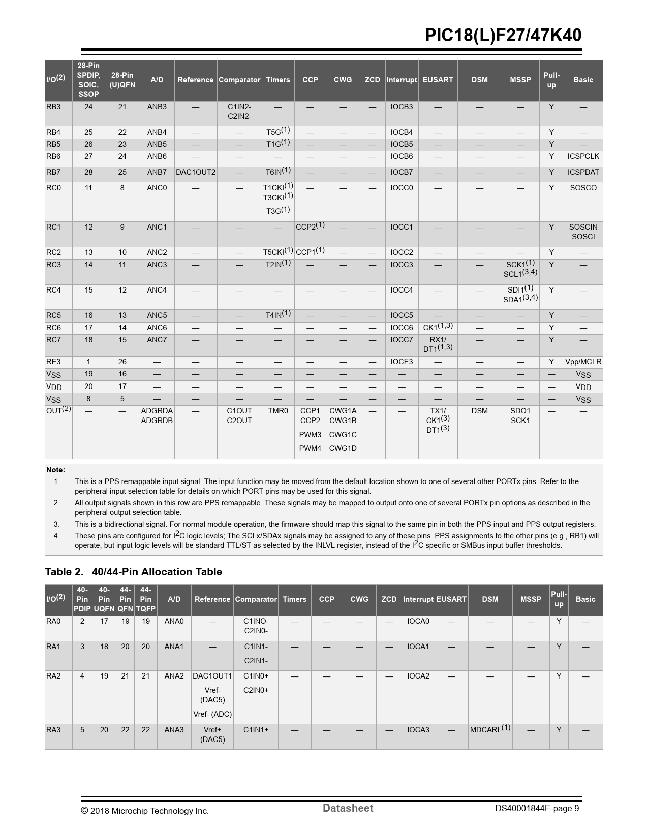

PIC18(L)F27/47K40 28-Pin SPDIP, 28-Pin Pull- I/O(2) A/D Reference Comparator Timers CCP CWG ZCD Interrupt EUSART DSM MSSP Basic SOIC, (U)QFN up SSOP
RB3 24 21 ANB3 — C1IN2- — — — — IOCB3 — — — Y — C2IN2- RB4 25 22 ANB4 — — T5G(1) — — — IOCB4 — — — Y — RB5 26 23 ANB5 — — T1G(1) — — — IOCB5 — — — Y — RB6 27 24 ANB6 — — — — — — IOCB6 — — — Y ICSPCLK RB7 28 25 ANB7 DAC1OUT2 — T6IN(1) — — — IOCB7 — — — Y ICSPDAT RC0 11 8 ANC0 — — T1CKI(1) — — — IOCC0 — — — Y SOSCO T3CKI(1) T3G(1) RC1 12 9 ANC1 — — — CCP2(1) — — IOCC1 — — — Y SOSCIN SOSCI RC2 13 10 ANC2 — — T5CKI(1) CCP1(1) — — IOCC2 — — — Y — RC3 14 11 ANC3 — — T2IN(1) — — — IOCC3 — — SCK1(1) Y — SCL1(3,4) RC4 15 12 ANC4 — — — — — — IOCC4 — — SDI1(1) Y — SDA1(3,4) RC5 16 13 ANC5 — — T4IN(1) — — — IOCC5 — — — Y — RC6 17 14 ANC6 — — — — — — IOCC6 CK1(1,3) — — Y — RC7 18 15 ANC7 — — — — — — IOCC7 RX1/ — — Y — DT1(1,3) RE3 1 26 — — — — — — — IOCE3 — — — Y Vpp/MCLR VSS 19 16 — — — — — — — — — — — — VSS VDD 20 17 — — — — — — — — — — — — VDD VSS 8 5 — — — — — — — — — — — — VSS OUT(2) — — ADGRDA — C1OUT TMR0 CCP1 CWG1A — — TX1/ DSM SDO1 — — ADGRDB C2OUT CCP2 CWG1B CK1(3) SCK1 DT1(3) PWM3 CWG1C PWM4 CWG1D
Note: 
1. This is a PPS remappable input signal. The input function may be moved from the default location shown to one of several other PORTx pins. Refer to the peripheral input selection table for details on which PORT pins may be used for this signal. 2. All output signals shown in this row are PPS remappable. These signals may be mapped to output onto one of several PORTx pin options as described in the peripheral output selection table. 3. This is a bidirectional signal. For normal module operation, the firmware should map this signal to the same pin in both the PPS input and PPS output registers. 4. These pins are configured for I2C logic levels; The SCLx/SDAx signals may be assigned to any of these pins. PPS assignments to the other pins (e.g., RB1) will operate, but input logic levels will be standard TTL/ST as selected by the INLVL register, instead of the I2C specific or SMBus input buffer thresholds.
Table 2.  40/44-Pin Allocation Table 40- 40- 44- 44- Pull- I/O(2) Pin Pin Pin Pin A/D Reference Comparator Timers CCP CWG ZCD Interrupt EUSART DSM MSSP Basic up PDIP UQFN QFN TQFP
RA0 2 17 19 19 ANA0 — C1INO- — — — — IOCA0 — — — Y — C2IN0- RA1 3 18 20 20 ANA1 — C1IN1- — — — — IOCA1 — — — Y — C2IN1- RA2 4 19 21 21 ANA2 DAC1OUT1 C1IN0+ — — — — IOCA2 — — — Y — Vref- C2IN0+ (DAC5) Vref- (ADC) RA3 5 20 22 22 ANA3 Vref+ C1IN1+ — — — — IOCA3 — MDCARL(1) — Y — (DAC5) © 2018 Microchip Technology Inc.
