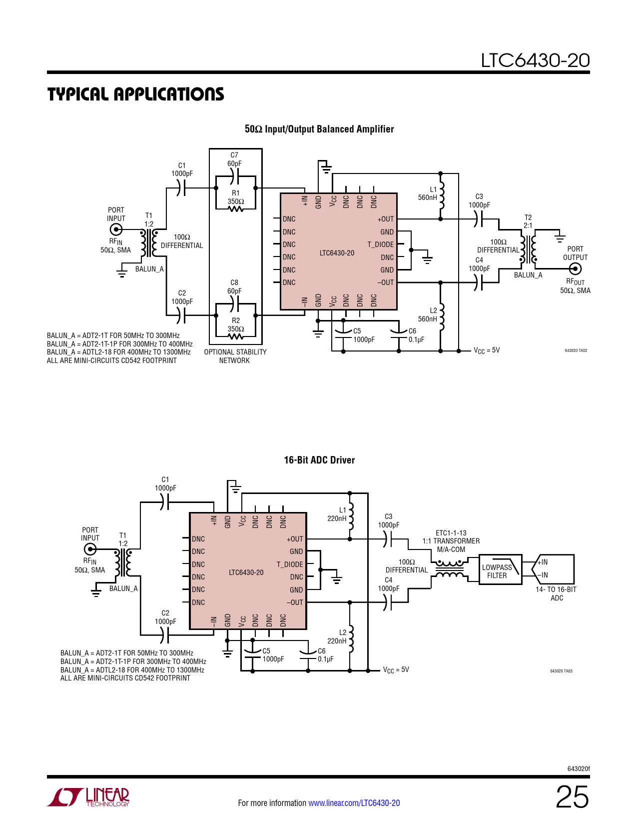

LTC6430-20
TYPICAL APPLICATIONS 50Ω Input/Output Balanced Amplifier
C7 C1 60pF 1000pF L1 R1 560nH C3 350Ω +IN 1000pF PORT GND V CC DNC DNC DNC T1 INPUT DNC +OUT T2 1:2 2:1 DNC GND RF 100Ω IN DIFFERENTIAL DNC T_DIODE 100Ω 50Ω, SMA DIFFERENTIAL PORT LTC6430-20 DNC DNC OUTPUT C4 • • BALUN_A DNC GND 1000pF BALUN_A C8 DNC –OUT RFOUT 60pF 50Ω, SMA C2 1000pF –IN GND V CC DNC DNC DNC L2 R2 560nH 350Ω BALUN_A = ADT2-1T FOR 50MHz TO 300MHz C5 C6 BALUN_A = ADT2-1T-1P FOR 300MHz TO 400MHz 1000pF 0.1µF V 643020 TA02 BALUN_A = ADTL2-18 FOR 400MHz TO 1300MHz OPTIONAL STABILITY CC = 5V ALL ARE MINI-CIRCUITS CD542 FOOTPRINT NETWORK
16-Bit ADC Driver
C1 1000pF L1 220nH C3 +IN 1000pF PORT GND V CC DNC DNC DNC T1 ETC1-1-13 INPUT DNC +OUT 1:2 1:1 TRANSFORMER DNC GND M/A-COM RF • • IN 100Ω +IN DNC T_DIODE 50Ω, SMA LOWPASS LTC6430-20 DIFFERENTIAL DNC DNC FILTER –IN C4 BALUN_A DNC GND 1000pF 14- TO 16-BIT ADC DNC –OUT C2 1000pF –IN GND V CC DNC DNC DNC L2 220nH C5 C6 BALUN_A = ADT2-1T FOR 50MHz TO 300MHz 1000pF 0.1µF BALUN_A = ADT2-1T-1P FOR 300MHz TO 400MHz BALUN_A = ADTL2-18 FOR 400MHz TO 1300MHz VCC = 5V 643020 TA03 ALL ARE MINI-CIRCUITS CD542 FOOTPRINT 643020f For more information www.linear.com/LTC6430-20 25 Document Outline Features Applications Description Typical Application Absolute Maximum Ratings Pin Configuration Order Information DC Electrical Characteristics AC Electrical Characteristics Typical Performance Characteristics Pin Functions Block Diagram Test Circuit A Operation Applications Information Differential S Parameters Typical Applications Package Description Typical Application Related Parts
