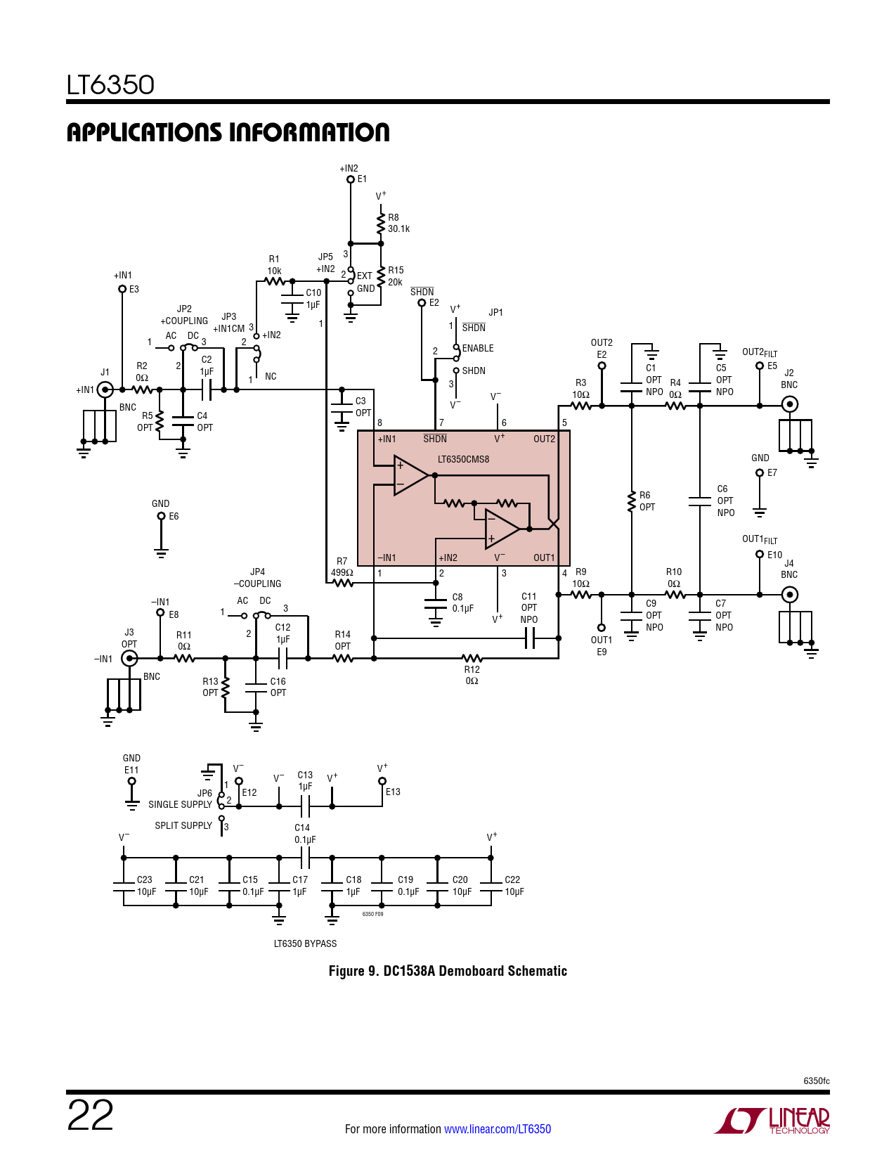

Страниц / Страница28 / 22 — applicaTions inForMaTion. Figure 9. DC1538A Demoboard Schematic
applicaTions inForMaTion Figure 9 DC1538A Demoboard Schematic
+IN2E1 V+ R8 30.1k 3 R1 JP5 10k +IN2 +IN1 2 R15 EXT 20k E3 C10 GND SHDNE2 JP2 1µF V+ JP1 +COUPLING JP3 1 +IN1CM 3 1 SHDN AC DC +IN2 1 3 2 OUT2 2 ENABLE OUT2 C2 E2 FILT R2 2 C1 C5 E5 J1 1µF SHDN 0Ω J2 1 NC 3 R3 OPT R4 OPT +IN1 BNC V– 10Ω NPO 0Ω NPO BNC C3 V– R5 C4 OPT OPT OPT 8 7 6 5 +IN1 SHDN V+ OUT2 LT6350CMS8 GND + E7 – C6 R6 OPT GND OPT – NPO E6 + OUT1FILT R7 –IN1 +IN2 V– OUT1 E10 J4 JP4 499Ω 1 2 3 4 R9 R10 BNC –COUPLING 10Ω 0Ω –IN1 AC DC C8 C11 C9 C7 OPT E8 1 3 0.1µF OPT OPT V+ NPO NPO NPO J3 R11 2 C12 R14 1µF OUT1 OPT 0Ω OPT E9 –IN1 R12 BNC R13 C16 0Ω OPT OPT GND E11 V– C13 V+ V– V+ 1 1µF JP6 E12 E13 2 SINGLE SUPPLY SPLIT SUPPLY 3 C14 0.1µF V+ V– C23 C21 C15 C17 C18 C19 C20 C22 10µF 10µF 0.1µF 1µF 1µF 0.1µF 10µF 10µF 6350 F09 LT6350 BYPASS
