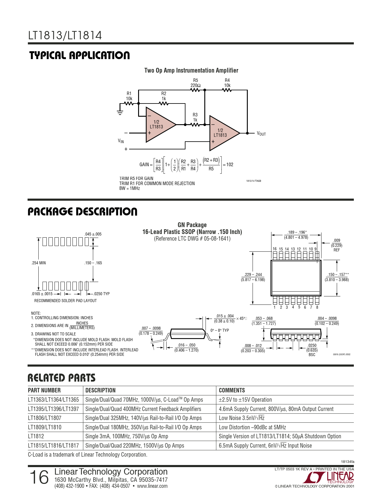

U TYPICAL APPLICATIO Two Op Amp Instrumentation Amplifier
R5 R4 220Ω 10k R1 R2 10k 1k R3 – 1k 1/2 – LT1813 – + 1/2 VOUT LT1813 VIN + + ⎡ ⎡ 2 3 ⎤ 4 ⎢ 1 2 3 ( ) R ⎤ ⎛ ⎞ ⎛R R ⎞ R + R GAIN = ⎢ ⎥ 1+ ⎥ = 102 R3 ⎢ ⎝⎜ 2⎠⎟ + ⎝⎜ R1 R4⎠⎟ + R ⎣ ⎦ 5 ⎥ ⎣ ⎦ TRIM R5 FOR GAIN 1813/14 TA03 TRIM R1 FOR COMMON MODE REJECTION BW = 1MHz
U PACKAGE DESCRIPTIO GN Package 16-Lead Plastic SSOP (Narrow .150 Inch)
.189 – .196* .045 ±.005 (Reference LTC DWG # 05-08-1641) (4.801 – 4.978) .009 (0.229) 16 15 14 13 12 11 10 9 REF .254 MIN .150 – .165 .229 – .244 .150 – .157** (5.817 – 6.198) (3.810 – 3.988) .0165 ± .0015 .0250 TYP RECOMMENDED SOLDER PAD LAYOUT 1 2 3 4 5 6 7 8 NOTE: .015 ± .004 1. CONTROLLING DIMENSION: INCHES × 45° .053 – .068 .004 – .0098 (0.38 ± 0.10) INCHES (1.351 – 1.727) (0.102 – 0.249) 2. DIMENSIONS ARE IN (MILLIMETERS) .007 – .0098 0° – 8° TYP 3. DRAWING NOT TO SCALE (0.178 – 0.249) *DIMENSION DOES NOT INCLUDE MOLD FLASH. MOLD FLASH SHALL NOT EXCEED 0.006" (0.152mm) PER SIDE .016 – .050 .008 – .012 .0250 **DIMENSION DOES NOT INCLUDE INTERLEAD FLASH. INTERLEAD (0.406 – 1.270) (0.203 – 0.305) (0.635) GN16 (SSOP) 0502 FLASH SHALL NOT EXCEED 0.010" (0.254mm) PER SIDE BSC
