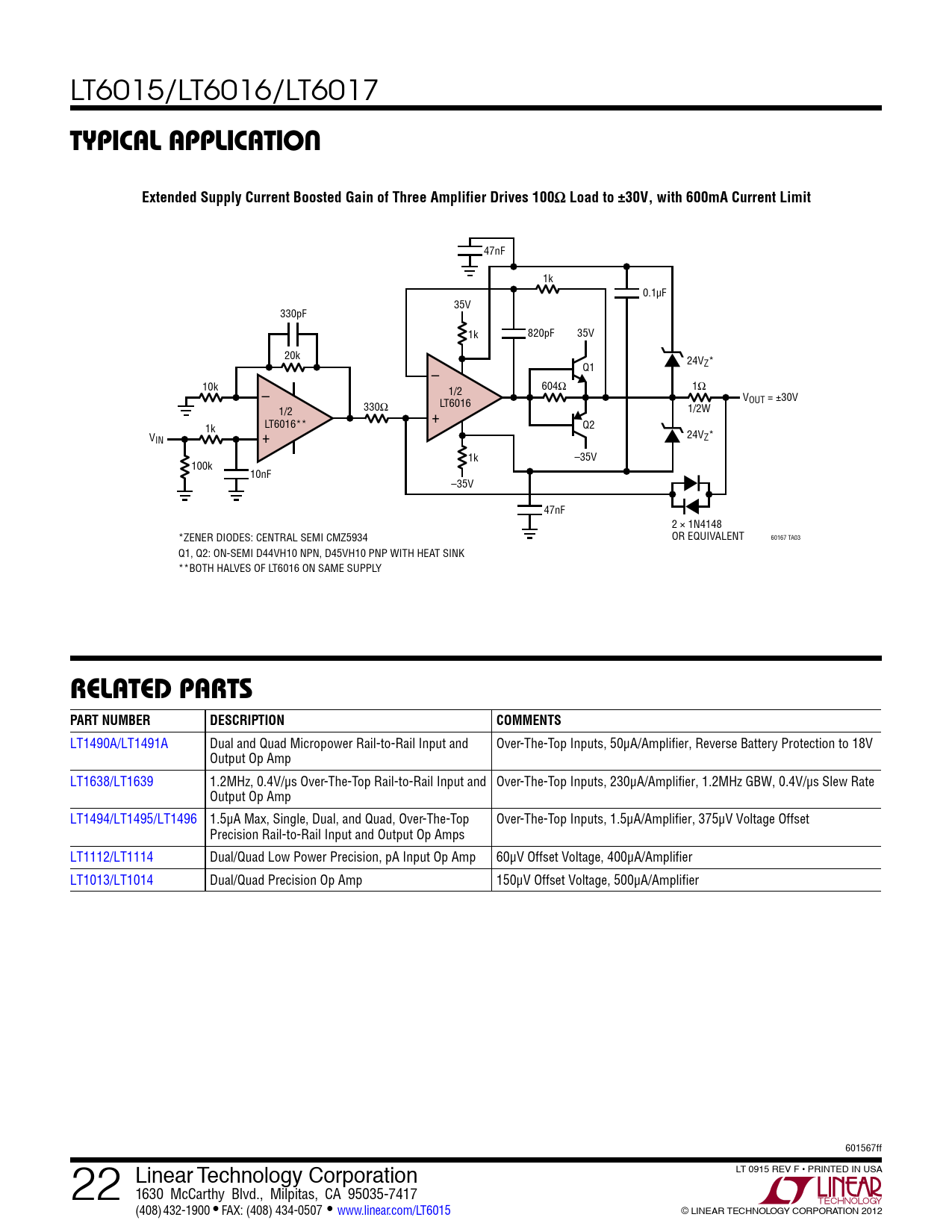

LT6015/LT6016/LT6017
Typical applicaTion Extended Supply Current Boosted Gain of Three Amplifier Drives 100Ω Load to ±30V, with 600mA Current Limit
47nF 1k 0.1µF 35V 330pF 1k 820pF 35V 20k 24VZ* – Q1 10k 604Ω 1Ω 1/2 – LT6016 VOUT = ±30V 1/2 330Ω + 1/2W LT6016** Q2 1k V 24V IN + Z* 1k –35V 100k 10nF –35V 47nF 2 × 1N4148 *ZENER DIODES: CENTRAL SEMI CMZ5934 OR EQUIVALENT 60167 TA03 Q1, Q2: ON-SEMI D44VH10 NPN, D45VH10 PNP WITH HEAT SINK **BOTH HALVES OF LT6016 ON SAME SUPPLY
relaTeD parTs PART NUMBER DESCRIPTION COMMENTS
LT1490A/LT1491A Dual and Quad Micropower Rail-to-Rail Input and Over-The-Top Inputs, 50μA/Amplifier, Reverse Battery Protection to 18V Output Op Amp LT1638/LT1639 1.2MHz, 0.4V/µs Over-The-Top Rail-to-Rail Input and Over-The-Top Inputs, 230μA/Amplifier, 1.2MHz GBW, 0.4V/µs Slew Rate Output Op Amp LT1494/LT1495/LT1496 1.5μA Max, Single, Dual, and Quad, Over-The-Top Over-The-Top Inputs, 1.5μA/Amplifier, 375μV Voltage Offset Precision Rail-to-Rail Input and Output Op Amps LT1112/LT1114 Dual/Quad Low Power Precision, pA Input Op Amp 60μV Offset Voltage, 400μA/Amplifier LT1013/LT1014 Dual/Quad Precision Op Amp 150μV Offset Voltage, 500μA/Amplifier 601567ff 22 LT 0915 REV F • PRINTED IN USA Linear Technology Corporation 1630 McCarthy Blvd., Milpitas, CA 95 F0o3r 5m-o 7 r4e in 17 formation www.linear.com/LT6015 (408) 432-1900 ● FAX: (408) 434-0507 ● www.linear.com/LT6015 © LINEAR TECHNOLOGY CORPORATION 2012 Document Outline Features Applications Description Typical Application Absolute Maximum Ratings Pin Configuration Order Information Electrical Characteristics Typical Performance Characteristics Applications Information Simplified Schematic Typical Applications Package Description Revision History Related Parts
