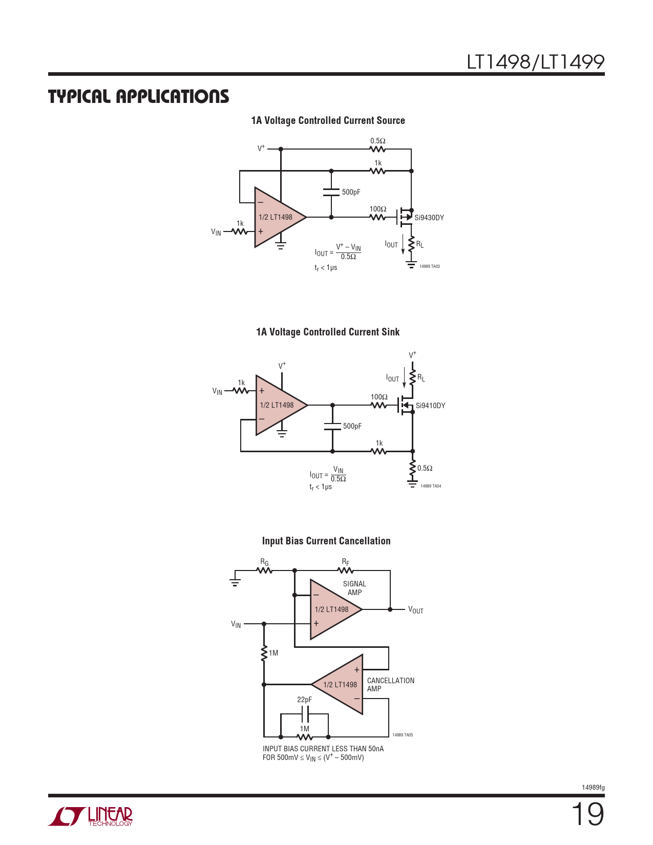

TYPICAL APPLICATIONS. 1A Voltage Controlled Current Source. 1A Voltage Controlled Current Sink
TYPICAL APPLICATIONS 1A Voltage Controlled Current Source 1A Voltage Controlled Current Sink

LT1498/LT1499
0.5Ω V+ 1k 500pF – 100Ω 1/2 LT1498 Si9430DY 1k VIN + IOUT RL V+ – V I IN OUT = 0.5Ω tr < 1μs 14989 TA03
V+ V+ I R 1k OUT L VIN + 100Ω 1/2 LT1498 Si9410DY – 500pF 1k V 0.5Ω I IN OUT = 0.5Ω 14989 TA04 tr < 1μs
Input Bias Current Cancellation
