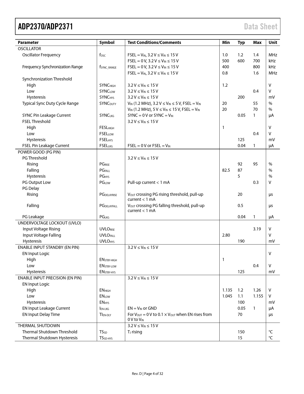

ADP2370/ADP2371. Data Sheet. Parameter. Symbol. Test Conditions/Comments. Min. Typ. Max. Unit
ADP2370/ADP2371 Data Sheet Parameter Symbol Test Conditions/Comments Min Typ Max Unit
