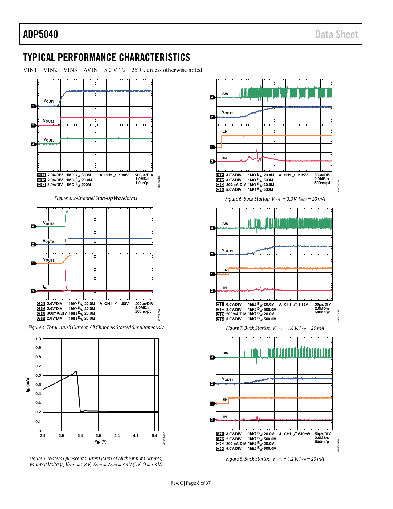

ADP5040. Data Sheet. TYPICAL PERFORMANCE CHARACTERISTICS. VOUT1. VOUT2. VOUT3. IIN. CH4 2.0V/DIV 1MΩ BW 500M. A CH2 1.88V. 200µs/DIV
ADP5040 Data Sheet TYPICAL PERFORMANCE CHARACTERISTICS VOUT1 VOUT2 VOUT3 IIN CH4 2.0V/DIV 1MΩ BW 500M A CH2 1.88V 200µs/DIV
VIN1 = VIN2 = VIN3 = AVIN = 5.0 V, TA = 25°C, unless otherwise noted.
SW 4 VOUT1 2 VOUT1 2 VOUT2 3 EN VOUT3 4 1 IIN 3 CH4 2.0V/DIV 1MΩ BW 500M A CH2 1.88V 200µs/DIV CH1 4.0V/DIV 1MΩ B A CH1 2.32V 50µs/DIV W 20.0M CH2 2.0V/DIV 1MΩ B 1.0MS/s

09665- Figure 3. 3-Channel Start-Up Waveforms Figure 6. Buck Startup, VOUT1 = 3.3 V, IOUT2 = 20 mA

09665- Figure 4. Total Inrush Current, All Channels Started Simultaneously Figure 7. Buck Startup, VOUT1 = 1.8 V, IOUT = 20 mA

09665- Figure 5. System Quiescent Current (Sum of All the Input Currents) Figure 8. Buck Startup, VOUT1 = 1.2 V, IOUT = 20 mA vs. Input Voltage, VOUT1 = 1.8 V, VOUT2 = VOUT3 = 3.3 V (UVLO = 3.3 V) Rev. C | Page 8 of 37 Document Outline FEATURES GENERAL DESCRIPTION FUNCTIONAL BLOCK DIAGRAM TABLE OF CONTENTS REVISION HISTORY SPECIFICATIONS GENERAL SPECIFICATIONS BUCK SPECIFICATIONS LDO1, LDO2 SPECIFICATIONS INPUT AND OUTPUT CAPACITOR, RECOMMENDED SPECIFICATIONS ABSOLUTE MAXIMUM RATINGS THERMAL RESISTANCE ESD CAUTION PIN CONFIGURATION AND FUNCTION DESCRIPTIONS TYPICAL PERFORMANCE CHARACTERISTICS THEORY OF OPERATION POWER MANAGEMENT UNIT Thermal Protection Undervoltage Lockout Enable/Shutdown Active Pull-Down BUCK SECTION Control Scheme PWM Mode Power Save Mode (PSM) PSM Current Threshold Short-Circuit Protection Soft Start Current Limit 100% Duty Operation LDO SECTION APPLICATIONS INFORMATION BUCK EXTERNAL COMPONENT SELECTION Feedback Resistors Inductor Output Capacitor Input Capacitor LDO EXTERNAL COMPONENT SELECTION Feedback Resistors Output Capacitor Input Bypass Capacitor Input and Output Capacitor Properties POWER DISSIPATION/THERMAL CONSIDERATIONS Buck Regulator Power Dissipation LDO Regulator Power Dissipation Junction Temperature APPLICATION DIAGRAM PCB LAYOUT GUIDELINES SUGGESTED LAYOUT BILL OF MATERIALS FACTORY PROGRAMMABLE OPTIONS OUTLINE DIMENSIONS ORDERING GUIDE
