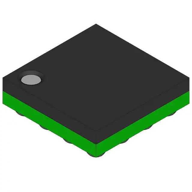

Single/Dual/Quad, Low-Cost, UCSP/SOT23, Low-Power, Rail-to-Rail I/O Op Amps MAX4322/MAX4323/MAX4326/MAX4327/MAX4329 General Description ____________________________Features
The MAX4322/MAX4323/MAX4326/MAX4327/MAX4329 ♦
6-Bump UCSP Package (MAX4323)
family of operational amplifiers combines wide bandwidth ♦
2.4V to 6.5V Single-Supply Operation
and excellent DC accuracy with Rail-to-Rail® operation at the inputs and outputs. These devices consume only ♦
Rail-to-Rail Input Common-Mode Voltage Range
650µA per amplifier and operate from either a single sup- ♦
Rail-to-Rail Output Voltage Swing
ply (2.4V to 6.5V) or dual supplies (±1.2V to ±3.25V). These unity-gain-stable amplifiers are capable of driving 250Ω ♦
5MHz Gain-Bandwidth Product
loads and have a 5MHz gain-bandwidth product. The ♦
650µA Quiescent Current per Amplifier
MAX4323 and MAX4327 feature a low-power shutdown mode that reduces supply current to 25µA and places the ♦
700µV Offset Voltage
outputs in a high-impedance state. ♦
No Phase Reversal for Overdriven Inputs
With their rail-to-rail input common-mode range and ♦
Drive 250
Loads
output swing, these amplifiers are ideal for low-voltage, single-supply operation. In addition, low offset voltage ♦
25µA Shutdown Mode (MAX4323/MAX4327)
and high speed make them the ideal signal-condition- ♦
Unity-Gain Stable for Capacitive Loads
ing stages for precision, low-voltage data-acquisition
Up to 500pF
systems. The MAX4323 is offered in a small 6-bump chip-scale package (UCSP™). The MAX4322/MAX4323 are also
Ordering Information
available in space-saving SOT23 packages.
