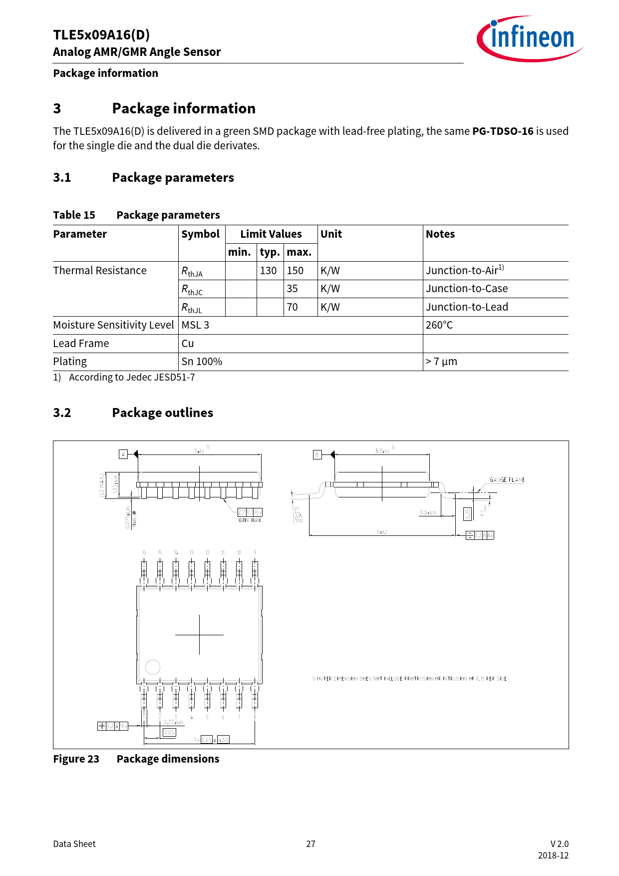

TLE5x09A16(D) Analog AMR/GMR Angle Sensor Package information 3 Package information
The TLE5x09A16(D) is delivered in a green SMD package with lead-free plating, the same
PG-TDSO-16
is used for the single die and the dual die derivates.
3.1 Package parameters Table 15 Package parameters Parameter Symbol Limit Values Unit Notes min. typ. max.
Thermal Resistance R 130 150 K/W Junction-to-Air1) thJA R 35 K/W Junction-to-Case thJC R 70 K/W Junction-to-Lead thJL Moisture Sensitivity Level MSL 3 260°C Lead Frame Cu Plating Sn 100% > 7 µm 1) According to Jedec JESD51-7
3.2 Package outlines Figure 23 Package dimensions
