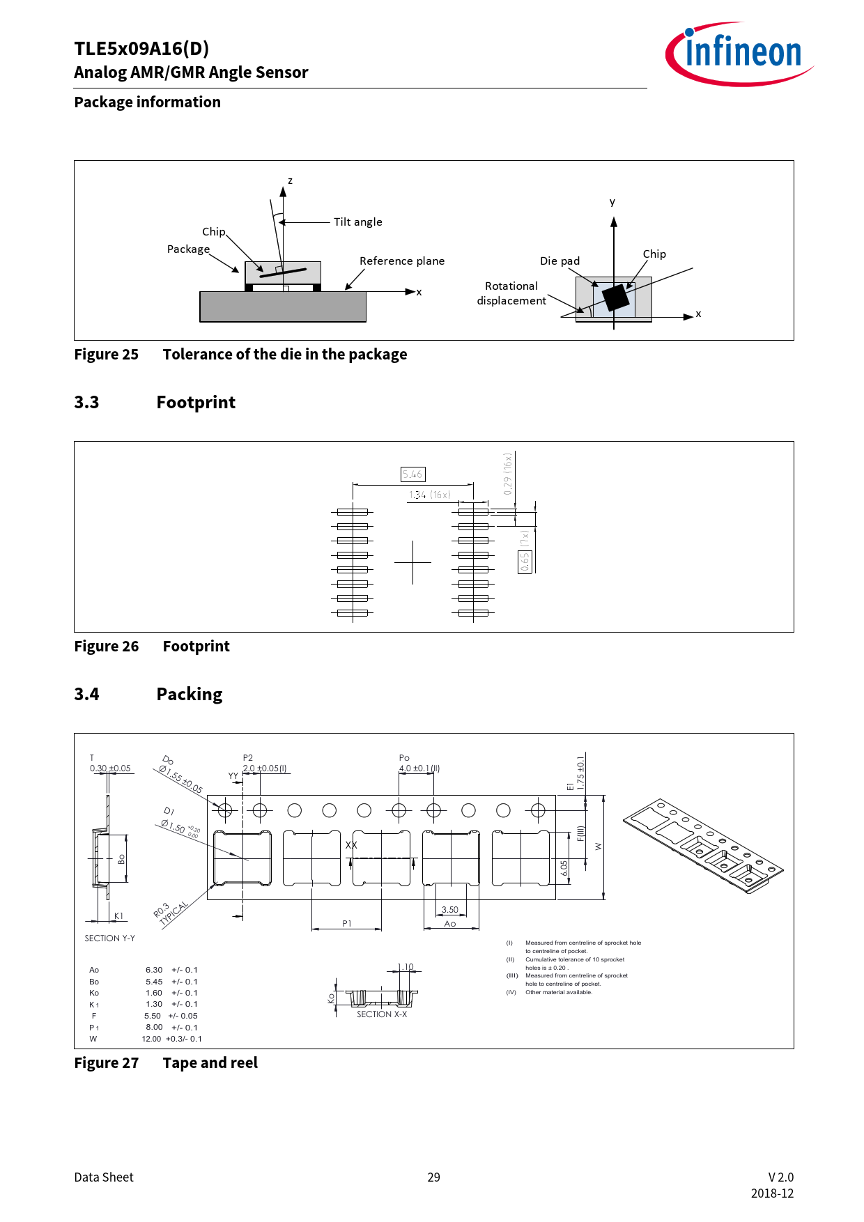

TLE5x09A16(D) Analog AMR/GMR Angle Sensor. Package information. Figure 25 Tolerance of the die in the package. 3.3. Footprint
TLE5x09A16(D) Analog AMR/GMR Angle Sensor Package information Figure 25 Tolerance of the die in the package 3.3 Footprint
z y Tilt angle Chip Package Chip Reference plane Die pad Rotational x displacement x
Figure 25 Tolerance of the die in the package 3.3 Footprint Figure 26 Footprint 3.4 Packing
T Do P2 Po 0.30 ±0.05 1.55 2.0 ±0.05(I) 4.0 ±0.1(II) ±0.1 ±0.05 YY E1 1.75 D1 1.50 +0.20 0.00 F(III) XX W Bo 6.05 K1 R0.3 3.50 TYPICAL P1 Ao SECTION Y-Y (I) Measured from centreline of sprocket hole to centreline of pocket. (II) Cumulative tolerance of 10 sprocket 1.10 Ao 6.30 +/- 0.1 holes is ± 0.20 . (III) Measured from centreline of sprocket Bo 5.45 +/- 0.1 hole to centreline of pocket. (IV) Other material available. Ko 1.60 +/- 0.1 Ko K 1 1.30 +/- 0.1 F 5.50 +/- 0.05 SECTION X-X P 1 8.00 +/- 0.1 W 12.00 +0.3/- 0.1
Figure 27 Tape and reel
