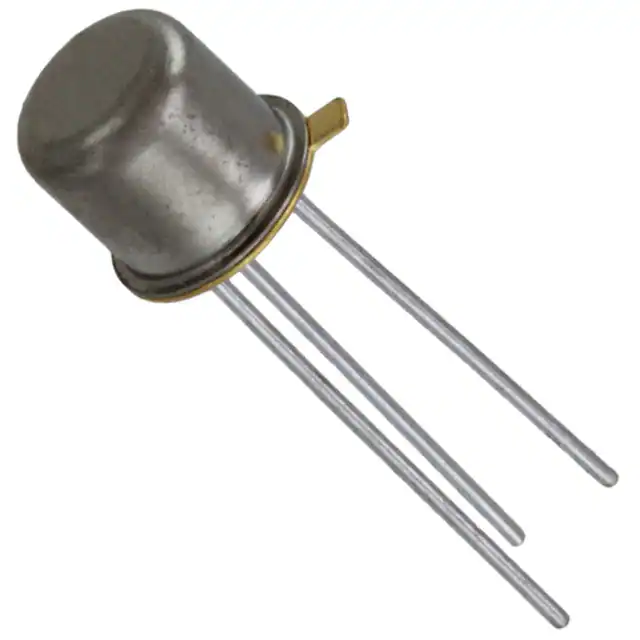

2N3019, 2N3019S, 2N3700 PACKAGE DIMENSIONS TO−5 3−Lead
CASE 205AA ISSUE B
B
NOTES: 1. DIMENSIONING AND TOLERANCING PER ASME Y14.5M, 1994.
A DETAIL X
2. CONTROLLING DIMENSION: INCHES.
B
3. DIMENSION J MEASURED FROM DIAMETER A TO EDGE. 4. LEAD TRUE POSITION TO BE DETERMINED AT THE GUAGE
U P C
PLANE DEFINED BY DIMENSION R. 5. DIMENSION F APPLIES BETWEEN DIMENSION P AND L.
U
6. DIMENSION D APPLIES BETWEEN DIMENSION L AND K. 7. BODY CONTOUR OPTIONAL WITHIN ZONE DEFINED BY DIMEN­
L SEATING
SIONS A, B, AND T.
R A PLANE F
8. DIMENSION B SHALL NOT VARY MORE THAN 0.010 IN ZONE P.
K NOTE 5 MILLIMETERS INCHES DIM MIN MAX MIN MAX E A
8.89 9.40 0.350 0.370
T B
8.00 8.51 0.315 0.335
NOTE 7 C
6.10 6.60 0.240 0.260
DETAIL X 3X D D
0.41 0.53 0.016 0.021
NOTES 4 & 6 E
0.23 3.18 0.009 0.125 0.007 (0.18MM) A B S C M
F
0.41 0.48 0.016 0.019
H
0.71 0.86 0.028 0.034
J
0.73 1.02 0.029 0.040
N K
38.10 44.45 1.500 1.750
H L
6.35 --- 0.250 ---
2 M
45 BSC 45 BSC
1 3
_ _
N
5.08 BSC 0.200 BSC
P
--- 1.27 --- 0.050
M J R
1.37 BSC 0.054 BSC
T
--- 0.76 --- 0.030
LEAD IDENTIFICATION U
2.54 --- 0.100 ---
C DETAIL
STYLE 1: PIN 1. EMITTER 2. BASE 3. COLLECTOR
TO−39 3−Lead
CASE 205AB ISSUE A
B
A DETAIL X
B
U P C
U
L SEATING
SIONS A, B, AND T.
R A PLANE F
T B
NOTE 7 C
DETAIL X 3X D D
NOTES 4 & 6 E
F
H
J
N K
12.70 14.73 0.500 0.580
H L
6.35 --- 0.250 ---
2 M
45 BSC 45 BSC
1 3
_ _
N
5.08 BSC 0.200 BSC
P
--- 1.27 --- 0.050
M J R
1.37 BSC 0.054 BSC
T
--- 0.76 --- 0.030
2.54 --- 0.100 ---
C DETAIL
