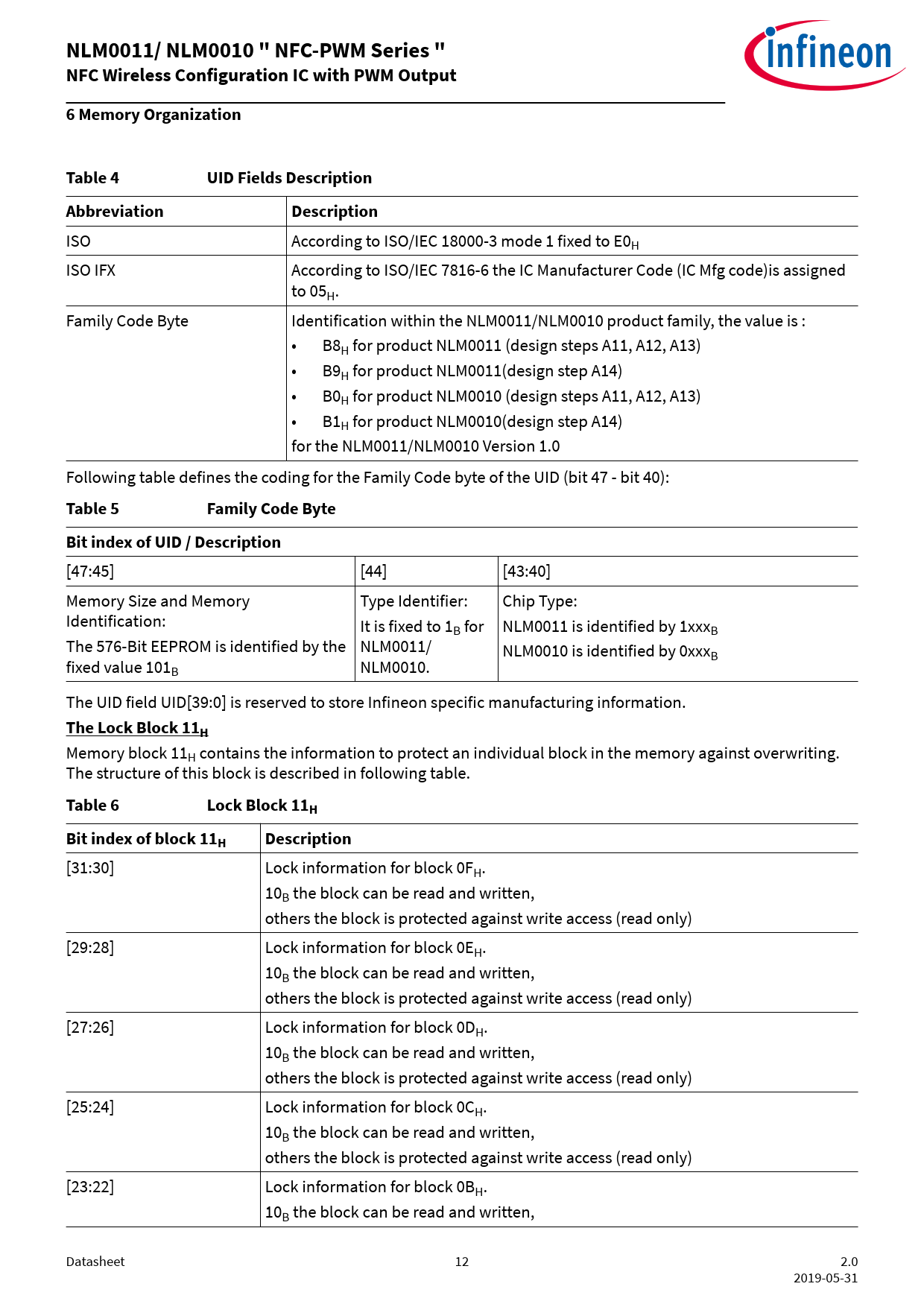

NLM0011/ NLM0010 " NFC-PWM Series " NFC Wireless Configuration IC with PWM Output 6 Memory Organization Table 4 UID Fields Description Abbreviation Description
ISO According to ISO/IEC 18000-3 mode 1 fixed to E0H ISO IFX According to ISO/IEC 7816-6 the IC Manufacturer Code (IC Mfg code)is assigned to 05H. Family Code Byte Identification within the NLM0011/NLM0010 product family, the value is : • B8H for product NLM0011 (design steps A11, A12, A13) • B9H for product NLM0011(design step A14) • B0H for product NLM0010 (design steps A11, A12, A13) • B1H for product NLM0010(design step A14) for the NLM0011/NLM0010 Version 1.0 Following table defines the coding for the Family Code byte of the UID (bit 47 - bit 40):
Table 5 Family Code Byte Bit index of UID / Description
[47:45] [44] [43:40] Memory Size and Memory Type Identifier: Chip Type: Identification: It is fixed to 1B for NLM0011 is identified by 1xxxB The 576-Bit EEPROM is identified by the NLM0011/ NLM0010 is identified by 0xxxB fixed value 101B NLM0010. The UID field UID[39:0] is reserved to store Infineon specific manufacturing information.
The Lock Block 11H
Memory block 11H contains the information to protect an individual block in the memory against overwriting. The structure of this block is described in following table.
Table 6 Lock Block 11H Bit index of block 11H Description
[31:30] Lock information for block 0FH. 10B the block can be read and written, others the block is protected against write access (read only) [29:28] Lock information for block 0EH. 10B the block can be read and written, others the block is protected against write access (read only) [27:26] Lock information for block 0DH. 10B the block can be read and written, others the block is protected against write access (read only) [25:24] Lock information for block 0CH. 10B the block can be read and written, others the block is protected against write access (read only) [23:22] Lock information for block 0BH. 10B the block can be read and written, Datasheet 12 2.0 2019-05-31 Document Outline Features Description Table of contents 1 General 2 Feature Overview 3 Application Overview 4 Pin Description 5 Functional Description 6 Memory Organization 7 Application and User Memory Access Control 8 NLM0011/NLM0010 EEPROM Shipment Content (Infineon to Customer) 9 Constant Lumen Output (CLO) and Operating Time Counting (OTC) 10 PWM Overview 11 NLM0011/ NLM0010 Command Set 12 NLM0011/ NLM0010 Electrical Characteristics 13 Package Outline Revision history Disclaimer
