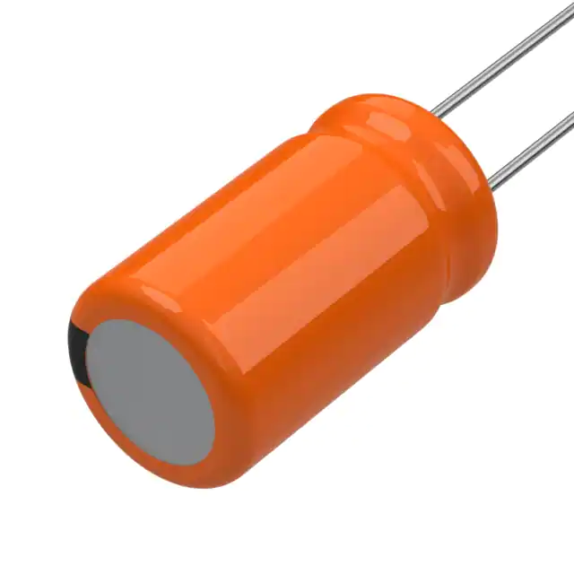

235 EDLC-HVR ENYCAP™
www.vishay.com Vishay BCcomponents
Table 2 ELECTRICAL DATA AND ORDERING INFORMATION IL IP MAX. STORED SPECIFIC MAX. U MAX. LEAKAGE R UMT (1) UCT (2) NOMINAL MAX. ENERGY ENERGY ORDERING CODE PEAK (V) (V) (V) US CR (3) ESR CASE SIZE ESR AC CURRENT E AT UR Ed AT UR MAL2235... (V) 100 Hz DC (3) INITIAL, CURRENT Ø D x L INITIAL AFTER (Wh) (Wh/kg) (< 1 s) (F) 1 kHz (A) (mm) (m ) (mA) (μA) (m ) FORM FORM FORM 65 °C 75 °C 85 °C 65 °C 85 °C 0.5 h 72 h 65 °C 85 °C 65 °C 85 °C CA TFA TRAY
3.0 2.8 2.6 3.15 5 10 x 20 39 32 12 10 2 25 0.006 0.005 2.8 2.1 51011E3 31011E3 - 3.0 2.8 2.6 3.15 7 10 x 25 35 28 12 10 3 35 0.009 0.007 2.9 2.2 51012E3 31012E3 - 3.0 2.8 2.6 3.15 8 12.5 x 20 32 25 15 12 4 40 0.010 0.008 2.5 1.9 51014E3 31014E3 - 3.0 2.8 2.6 3.15 10 10 x 30 31 24 15 12 4 45 0.013 0.009 3.6 2.7 51013E3 31013E3 - 3.0 2.8 2.6 3.15 12 12.5 x 25 30 23 17 14 5 55 0.015 0.011 3.0 2.3 51015E3 31015E3 - 3.0 2.8 2.6 3.15 15 12.5 x 30 27 20 20 17 6 70 0.019 0.014 3.4 2.6 51016E3 31016E3 - 3.0 2.8 2.6 3.15 20 16 x 20 28 22 25 20 8 75 0.025 0.019 4.2 3.1 51003E3 31003E3 91003E3 3.0 2.8 2.6 3.15 22 12.5 x 40 22 15 25 20 9 75 0.028 0.021 3.9 3.0 51017E3 - - 3.0 2.8 2.6 3.15 25 16 x 25 26 20 25 20 8 75 0.031 0.023 3.9 2.9 51006E3 31006E3 91006E3 3.0 2.8 2.6 3.15 25 18 x 20 24 19 25 20 8 75 0.031 0.023 4.5 3.4 51004E3 31004E3 91004E3 3.0 2.8 2.6 3.15 30 18 x 25 23 17 30 25 12 140 0.038 0.028 3.8 2.8 51007E3 31007E3 91007E3 3.0 2.8 2.6 3.15 35 16 x 31 24 18 30 25 15 200 0.044 0.033 4.9 3.7 51002E3 31002E3 91002E3 3.0 2.8 2.6 3.15 40 18 x 31 22 16 35 30 20 200 0.050 0.038 4.0 3.0 51001E3 31001E3 91001E3 3.0 2.8 2.6 3.15 50 18 x 35 19 14 35 30 25 250 0.063 0.047 4.3 3.2 51008E3 31008E3 91008E3 3.0 2.8 2.6 3.15 60 18 x 40 17 13 35 30 30 300 0.075 0.056 4.5 3.4 51009E3 - 91009E3
Notes
(2) UMT = rated voltage at 75 °C (3) UCT = rated voltage at upper category temperature (4) Rated capacitance CR and ESRDC
Table 3 ENDURANCE TEST DURATION AND USEFUL LIFE ENDURANCE USEFUL LIFE NOMINAL CASE SIZE CASE CODE AT 85 °C AT 85 °C Ø D x L (h) (h)
10 x 20 16 750 1000 10 x 25 16L 750 1000 10 x 30 16LL 750 1000 12.5 x 20 17 1000 1500 12.5 x 25 18 1000 1500 12.5 x 30 18L 1000 1500 12.5 x 40 18LL 1000 1500 16 x 20 19a 1000 2000 16 x 25 19 1000 2000 18 x 20 1820 1000 2000 18 x 25 1825 1000 2000 16 x 31 20 1000 2000 18 x 31 1831 1000 2000 18 x 35 22 1000 2000 18 x 40 1840 1000 2000 Revision: 08-Oct-2019
