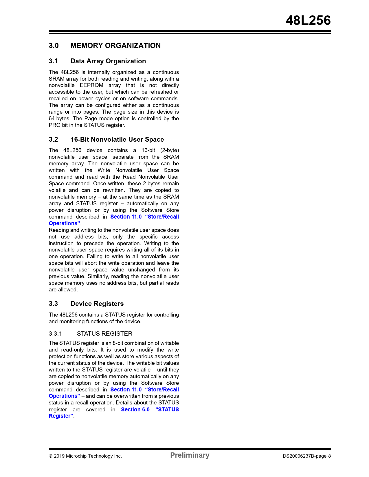

48L256 3.0 MEMORY ORGANIZATION 3.1 Data Array Organization
The 48L256 is internally organized as a continuous SRAM array for both reading and writing, along with a nonvolatile EEPROM array that is not directly accessible to the user, but which can be refreshed or recalled on power cycles or on software commands. The array can be configured either as a continuous range or into pages. The page size in this device is 64 bytes. The Page mode option is controlled by the PRO bit in the STATUS register.
3.2 16-Bit Nonvolatile User Space
The 48L256 device contains a 16-bit (2-byte) nonvolatile user space, separate from the SRAM memory array. The nonvolatile user space can be written with the Write Nonvolatile User Space command and read with the Read Nonvolatile User Space command. Once written, these 2 bytes remain volatile and can be rewritten. They are copied to nonvolatile memory – at the same time as the SRAM array and STATUS register – automatically on any power disruption or by using the Software Store command described in
Section 11.0 “Store/Recall Operations”
. Reading and writing to the nonvolatile user space does not use address bits, only the specific access instruction to precede the operation. Writing to the nonvolatile user space requires writing all of its bits in one operation. Failing to write to all nonvolatile user space bits wil abort the write operation and leave the nonvolatile user space value unchanged from its previous value. Similarly, reading the nonvolatile user space memory uses no address bits, but partial reads are allowed.
3.3 Device Registers
The 48L256 contains a STATUS register for controlling and monitoring functions of the device. 3.3.1 STATUS REGISTER The STATUS register is an 8-bit combination of writable and read-only bits. It is used to modify the write protection functions as well as store various aspects of the current status of the device. The writable bit values written to the STATUS register are volatile – until they are copied to nonvolatile memory automatically on any power disruption or by using the Software Store command described in
– and can be overwritten from a previous status in a recal operation. Details about the STATUS register are covered in
Section 6.0 “STATUS Register”
