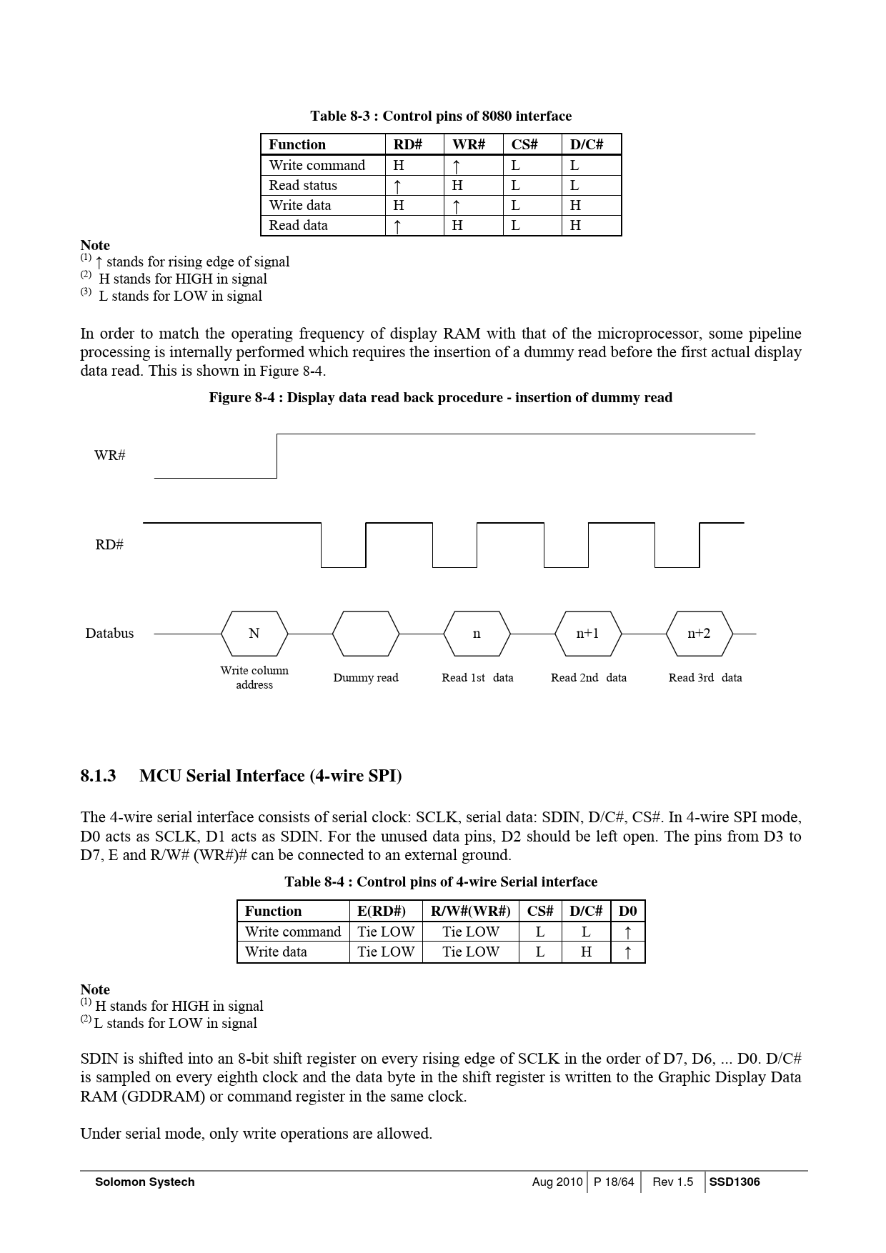

Table 8-3 : Control pins of 8080 interface. Function RD#. WR#. CS#. D/C#. Note
Table 8-3 : Control pins of 8080 interface Function RD# WR# CS# D/C# Note
Write command H ↑ L L Read status ↑ H L L Write data H ↑ L H Read data ↑ H L H
Note
(1) ↑ stands for rising edge of signal (2) H stands for HIGH in signal (3) L stands for LOW in signal In order to match the operating frequency of display RAM with that of the microprocessor, some pipeline processing is internally performed which requires the insertion of a dummy read before the first actual display data read. This is shown in Figure 8-4.
Figure 8-4 : Display data read back procedure - insertion of dummy read
WR# RD# Databus N n n+1 n+2 Write column Dummy read Read 1st data Read 2nd data Read 3rd data address
8.1.3 MCU Serial Interface (4-wire SPI)
The 4-wire serial interface consists of serial clock: SCLK, serial data: SDIN, D/C#, CS#. In 4-wire SPI mode, D0 acts as SCLK, D1 acts as SDIN. For the unused data pins, D2 should be left open. The pins from D3 to D7, E and R/W# (WR#)# can be connected to an external ground.
Table 8-4 : Control pins of 4-wire Serial interface Function E(RD#) R/W#(WR#) CS# D/C# D0
Write command Tie LOW Tie LOW L L ↑ Write data Tie LOW Tie LOW L H ↑
Note
(1) H stands for HIGH in signal (2) L stands for LOW in signal SDIN is shifted into an 8-bit shift register on every rising edge of SCLK in the order of D7, D6, ... D0. D/C# is sampled on every eighth clock and the data byte in the shift register is written to the Graphic Display Data RAM (GDDRAM) or command register in the same clock. Under serial mode, only write operations are allowed.
