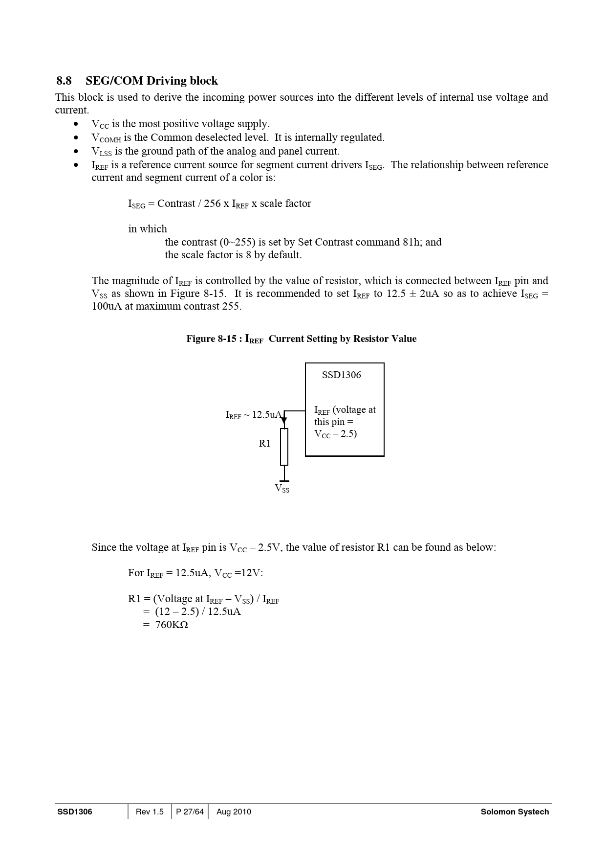

8.8 SEG/COM Driving block
This block is used to derive the incoming power sources into the different levels of internal use voltage and current. • VCC is the most positive voltage supply. • VCOMH is the Common deselected level. It is internally regulated. • VLSS is the ground path of the analog and panel current. • IREF is a reference current source for segment current drivers ISEG. The relationship between reference current and segment current of a color is: ISEG = Contrast / 256 x IREF x scale factor in which the contrast (0~255) is set by Set Contrast command 81h; and the scale factor is 8 by default. The magnitude of IREF is controlled by the value of resistor, which is connected between IREF pin and VSS as shown in Figure 8-15. It is recommended to set IREF to 12.5 ± 2uA so as to achieve ISEG = 100uA at maximum contrast 255.
Figure 8-15 : IREF Current Setting by Resistor Value
SSD1306 IREF (voltage at IREF ~ 12.5uA this pin = VCC – 2.5) R1 VSS Since the voltage at IREF pin is VCC – 2.5V, the value of resistor R1 can be found as below: For IREF = 12.5uA, VCC =12V: R1 = (Voltage at IREF – VSS) / IREF = (12 – 2.5) / 12.5uA = 760KΩ
