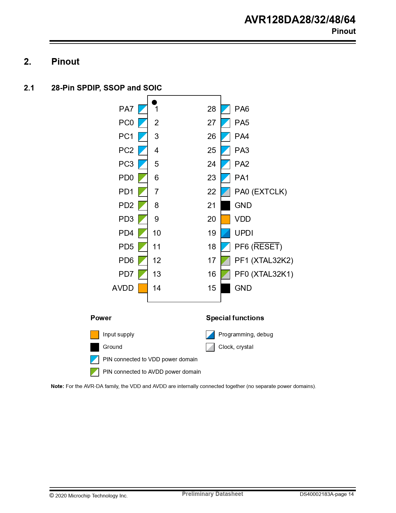

AVR128DA28/32/48/64 Pinout 2. Pinout 2.1 28-Pin SPDIP, SSOP and SOIC
PA7 1 28 PA6 PC0 2 27 PA5 PC1 3 26 PA4 PC2 4 25 PA3 PC3 5 24 PA2 PD0 6 23 PA1 PD1 7 22 PA0 (EXTCLK) PD2 8 21 GND PD3 9 20 VDD PD4 10 19 UPDI PD5 11 18 PF6 (RESET) PD6 12 17 PF1 (XTAL32K2) PD7 13 16 PF0 (XTAL32K1) AVDD 14 15 GND
Power Special functions
Input supply Programming, debug Ground Clock, crystal PIN connected to VDD power domain PIN connected to AVDD power domain
Note:
For the AVR-DA family, the VDD and AVDD are internally connected together (no separate power domains). © 2020 Microchip Technology Inc.
