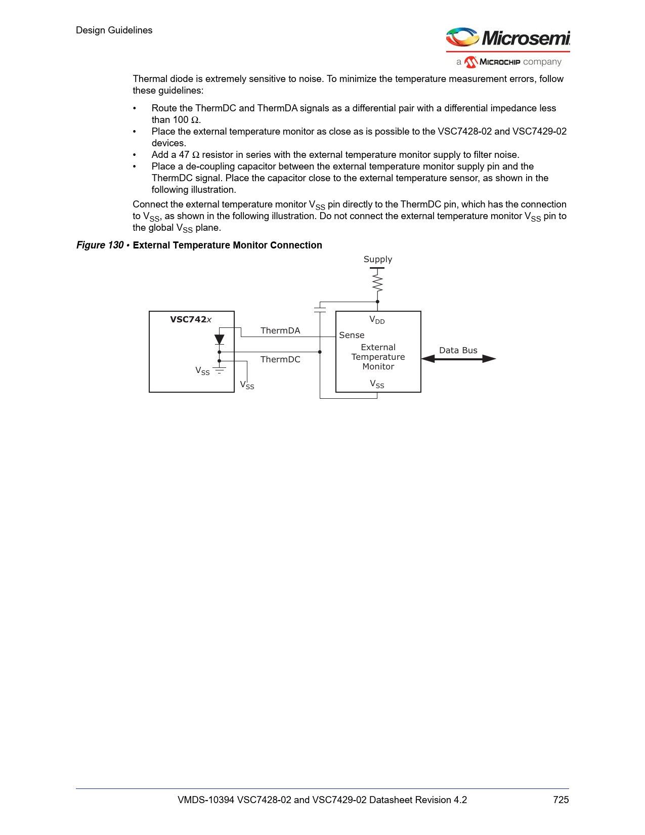

Design Guidelines Thermal diode is extremely sensitive to noise. To minimize the temperature measurement errors, follow these guidelines: • Route the ThermDC and ThermDA signals as a differential pair with a differential impedance less than 100 Ω. • Place the external temperature monitor as close as is possible to the VSC7428-02 and VSC7429-02 devices. • Add a 47 Ω resistor in series with the external temperature monitor supply to filter noise. • Place a de-coupling capacitor between the external temperature monitor supply pin and the ThermDC signal. Place the capacitor close to the external temperature sensor, as shown in the following illustration. Connect the external temperature monitor VSS pin directly to the ThermDC pin, which has the connection to VSS, as shown in the following illustration. Do not connect the external temperature monitor VSS pin to the global VSS plane.
Figure 130 • External Temperature Monitor Connection
Supply
VSC742
x VDD ThermDA Sense External Data Bus Temperature ThermDC Monitor VSS V V SS SS VMDS-10394 VSC7428-02 and VSC7429-02 Datasheet Revision 4.2 725 Document Outline 1 Revision History 1.1 Revision 4.2 1.2 Revision 4.1 1.3 Revision 4.0 1.4 Revision 2.0 2 Introduction 2.1 Register Notation 2.2 Standard References 2.3 Terms and Abbreviations 3 Product Overview 3.1 General Features 3.1.1 Layer-2 Switching 3.1.2 Multicast 3.1.3 Carrier Ethernet 3.1.4 Quality of Service 3.1.5 Security 3.1.6 Management 3.2 Applications 3.3 Related Products 3.4 Functional Overview 3.4.1 Frame Arrival 3.4.2 Basic and Advanced Frame Classification 3.4.3 VCAP-II Vitesse Content Aware Processor 3.4.4 Policing 3.4.5 Layer-2 Forwarding 3.4.6 Shared Queue System and Egress Scheduler 3.4.7 Rewriter and Frame Departure 3.4.8 CPU Port Module 3.4.9 Synchronous Ethernet and Precision Time Protocol 3.4.10 CPU System and Interfaces 4 Functional Descriptions 4.1 Port Modules 4.1.1 Port Module Numbering and Macro Connections 4.1.2 MAC 4.1.3 PCS 4.2 SERDES1G 4.2.1 SERDES1G Basic Configuration 4.2.2 SERDES1G Loopback Modes 4.2.3 Synchronous Ethernet 4.2.4 SERDES1G Deserializer Configuration 4.2.5 SERDES1G Serializer Configuration 4.2.6 SERDES1G Input Buffer Configuration 4.2.7 SERDES1G Output Buffer Configuration 4.2.8 SERDES1G Clock and Data Recovery (CDR) in 100BASE-FX 4.2.9 SERDES1G Energy Efficient Ethernet 4.2.10 SERDES1G Data Inversion 4.3 SERDES6G 4.3.1 SERDES6G Basic Configuration 4.3.2 SERDES6G Loopback Modes 4.3.3 Synchronous Ethernet 4.3.4 SERDES6G Deserializer Configuration 4.3.5 SERDES6G Serializer Configuration 4.3.6 SERDES6G Input Buffer Configuration 4.3.7 SERDES6G Output Buffer Configuration 4.3.8 SERDES6G Clock and Data Recovery (CDR) in 100BASE-FX 4.3.9 SERDES6G Energy Efficient Ethernet 4.3.10 SERDES6G Data Inversion 4.3.11 SERDES6G Signal Detection Enhancements 4.3.12 SERDES6G High-Speed I/O Configuration Bus 4.4 Copper Transceivers 4.4.1 Register Access 4.4.2 Cat5 Twisted Pair Media Interface 4.4.3 LED Interface 4.4.4 Ethernet Inline Powered Devices 4.4.5 IEEE 802.3af PoE Support 4.4.6 ActiPHY™ Power Management 4.4.7 Testing Features 4.4.8 VeriPHY™ Cable Diagnostics 4.5 Statistics 4.6 Classifier 4.6.1 General Data Extraction Setup 4.6.2 Frame Acceptance Filtering 4.6.3 QoS, DP, and DSCP Classification 4.6.4 VLAN Classification 4.6.5 Link Aggregation Code Generation 4.6.6 CPU Forwarding Determination 4.7 VCAP-II 4.7.1 Port Configuration 4.7.2 VCAP IS1 4.7.3 VCAP IS2 4.7.4 VCAP ES0 4.7.5 Range Checkers 4.7.6 VCAP-II Configuration 4.7.7 Advanced VCAP Operations 4.8 Analyzer 4.8.1 MAC Table 4.8.2 VLAN Table 4.8.3 Forwarding Engine 4.8.4 Analyzer Monitoring 4.9 Policers and Ingress Shapers 4.9.1 Policers 4.9.2 Ingress Shapers 4.10 Shared Queue System 4.10.1 Buffer Management 4.10.2 Frame Reference Management 4.10.3 Resource Depletion Condition 4.10.4 Configuration Example 4.10.5 Watermark Programming and Consumption Monitoring 4.10.6 Advanced Resource Management 4.10.7 Ingress Pause Request Generation 4.10.8 Tail Dropping 4.10.9 Test Utilities 4.10.10 Energy Efficient Ethernet 4.11 Scheduler and Shaper 4.11.1 Egress Shapers 4.11.2 Deficit Weighted Round Robin 4.11.3 Shaping and DWRR Scheduling Examples 4.12 Rewriter 4.12.1 VLAN Editing 4.12.2 DSCP Remarking 4.12.3 FCS Updating 4.12.4 CPU Extraction Header Insertion 4.13 CPU Port Module 4.13.1 Frame Extraction 4.13.2 Frame Injection 4.13.3 Network Processor Interface (NPI) 4.14 Layer-1 Timing 4.15 Hardware Timestamping 4.15.1 Timestamp Classification 4.15.2 One-Second Timer 4.15.3 Delay Timer 4.15.4 Time of Day Counter 4.16 Clocking and Reset 5 VCore-III System and CPU Interface 5.1 VCore-III Configurations 5.2 Clocking and Reset 5.2.1 Watchdog Timer 5.3 Shared Bus 5.3.1 Shared Bus Arbitration 5.3.2 SI Memory Region 5.3.3 PI Memory Region 5.3.4 DDR2 Memory Region 5.3.5 Switch Core Registers Memory Region 5.3.6 VCore-III Registers Memory Region 5.4 VCore-III CPU 5.4.1 Big Endian Support 5.4.2 Software Debug and Development 5.5 Manual Frame Injection and Extraction 5.5.1 Manual Frame Extraction 5.5.2 Manual Frame Injection 5.5.3 Frame Interrupts 5.6 Frame DMA 5.6.1 DMA Control Block Structures 5.6.2 Extraction 5.6.3 Injection 5.6.4 Frame DMA Interrupt 5.7 External CPU Support 5.7.1 Register Access and Multimaster Systems 5.7.2 Serial Interface in Slave Mode 5.7.3 Parallel Interface in Slave Mode 5.7.4 MIIM Interface in Slave Mode 5.7.5 Access to the VCore-III Shared Bus 5.7.6 Mailbox and Semaphores 5.8 VCore-III System Peripherals 5.8.1 Timers 5.8.2 UART 5.8.3 Two-Wire Serial Interface 5.8.4 MII Management Controller 5.8.5 GPIO Controller 5.8.6 Serial GPIO Controller 5.8.7 FAN Controller 5.8.8 Interrupt Controller 6 Features 6.1 Port Mapping 6.1.1 VSC7428 Port Mapping 6.1.2 VSC7429-02 Port Mapping 6.2 Switch Control 6.2.1 Switch Initialization 6.3 Port Module Control 6.3.1 MAC Configuration Port Mode Control 6.3.2 SerDes Configuration Port Mode Control 6.3.3 Port Reset Procedure 6.3.4 Port Counters 6.4 Layer-2 Switch 6.4.1 Basic Switching 6.4.2 Standard VLAN Operation 6.4.3 Provider Bridges and Q-in-Q Operation 6.4.4 Private VLANs 6.4.5 Asymmetric VLANs 6.4.6 Spanning Tree Protocols 6.4.7 IEEE 802.1X: Network Access Control 6.4.8 Link Aggregation 6.4.9 Simple Network Management Protocol (SNMP) 6.4.10 Mirroring 6.5 IGMP and MLD Snooping 6.5.1 IGMP and MLD Snooping Configuration 6.5.2 IP Multicast Forwarding Configuration 6.6 Quality of Service (QoS) 6.6.1 Basic QoS Configuration 6.6.2 IPv4 and IPv6 DSCP Remarking 6.6.3 Voice over IP (VoIP) 6.7 VCAP Applications 6.7.1 Notation for Control Lists Entries 6.7.2 Ingress Control Lists 6.7.3 Access Control Lists 6.7.4 Source IP Filter (SIP Filter) 6.7.5 DHCP Application 6.7.6 ARP Filtering 6.7.7 Ping Policing 6.7.8 TCP SYN Policing 6.8 CPU Extraction and Injection 6.8.1 Forwarding to CPU 6.8.2 Frame Extraction 6.8.3 Frame Injection 6.8.4 Frame Extraction and Injection Using An External CPU 6.9 Audio Video Bridging 6.10 Energy Efficient Ethernet 6.11 Carrier Ethernet Overview 6.11.1 Customer Bridge and Provider Bridge 6.11.2 MEF Services 6.11.3 MEF Bandwidth Profiles 6.11.4 MEF Service Attributes 6.11.5 Service Concept 6.11.6 Service Examples 6.11.7 Quality of Service Delivery 6.11.8 OAM and Protection Switching 6.11.9 Synchronous Ethernet Operation 6.11.10 IEEE 1588 Operation 7 Registers 7.1 Targets and Base Addresses 7.2 DEVCPU_ORG 7.2.1 DEVCPU_ORG:ORG 7.3 SYS 7.3.1 SYS:SYSTEM 7.3.2 SYS:SCH 7.3.3 SYS:SCH_LB 7.3.4 SYS:RES_CTRL 7.3.5 SYS:PAUSE_CFG 7.3.6 SYS:MMGT 7.3.7 SYS:MISC 7.3.8 SYS:STAT 7.3.9 SYS:PTP 7.3.10 SYS:POL 7.3.11 SYS:POL_MISC 7.3.12 SYS:ISHP 7.4 ANA 7.4.1 ANA:ANA 7.4.2 ANA:ANA_TABLES 7.4.3 ANA:PORT 7.4.4 ANA:COMMON 7.5 REW 7.5.1 REW:PORT 7.5.2 REW:COMMON 7.6 VCAP_CORE 7.6.1 VCAP_CORE:VCAP_CORE_CFG 7.6.2 VCAP_CORE:VCAP_CORE_CACHE 7.6.3 VCAP_CORE:VCAP_CORE_STICKY 7.6.4 VCAP_CORE:VCAP_CONST 7.6.5 VCAP_CORE:TCAM_BIST 7.7 VCAP_CORE 7.7.1 VCAP_CORE:VCAP_CORE_CFG 7.7.2 VCAP_CORE:VCAP_CORE_CACHE 7.7.3 VCAP_CORE:VCAP_CORE_STICKY 7.7.4 VCAP_CORE:VCAP_CONST 7.7.5 VCAP_CORE:TCAM_BIST 7.8 VCAP_CORE 7.8.1 VCAP_CORE:VCAP_CORE_CFG 7.8.2 VCAP_CORE:VCAP_CORE_CACHE 7.8.3 VCAP_CORE:VCAP_CORE_STICKY 7.8.4 VCAP_CORE:VCAP_CONST 7.8.5 VCAP_CORE:TCAM_BIST 7.9 DEVCPU_GCB 7.9.1 DEVCPU_GCB:CHIP_REGS 7.9.2 DEVCPU_GCB:SW_REGS 7.9.3 DEVCPU_GCB:VCORE_ACCESS 7.9.4 DEVCPU_GCB:GPIO 7.9.5 DEVCPU_GCB:DEVCPU_RST_REGS 7.9.6 DEVCPU_GCB:MIIM 7.9.7 DEVCPU_GCB:MIIM_READ_SCAN 7.9.8 DEVCPU_GCB:RAM_STAT 7.9.9 DEVCPU_GCB:MISC 7.9.10 DEVCPU_GCB:SIO_CTRL 7.9.11 DEVCPU_GCB:FAN_CFG 7.9.12 DEVCPU_GCB:FAN_STAT 7.9.13 DEVCPU_GCB:PTP_CFG 7.9.14 DEVCPU_GCB:PTP_STAT 7.9.15 DEVCPU_GCB:PTP_TIMERS 7.9.16 DEVCPU_GCB:MEMITGR 7.10 DEVCPU_QS 7.10.1 DEVCPU_QS:XTR 7.10.2 DEVCPU_QS:INJ 7.11 DEVCPU_PI 7.11.1 DEVCPU_PI:PI 7.12 HSIO 7.12.1 HSIO:PLL5G_CFG 7.12.2 HSIO:PLL5G_STATUS 7.12.3 HSIO:RCOMP_STATUS 7.12.4 HSIO:SYNC_ETH_CFG 7.12.5 HSIO:SERDES1G_ANA_CFG 7.12.6 HSIO:SERDES1G_DIG_CFG 7.12.7 HSIO:SERDES1G_DIG_STATUS 7.12.8 HSIO:MCB_SERDES1G_CFG 7.12.9 HSIO:SERDES6G_ANA_CFG 7.12.10 HSIO:SERDES6G_DIG_CFG 7.12.11 HSIO:MCB_SERDES6G_CFG 7.13 DEV_GMII 7.13.1 DEV_GMII:PORT_MODE 7.13.2 DEV_GMII:MAC_CFG_STATUS 7.14 DEV 7.14.1 DEV:DEV_CFG_STATUS 7.14.2 DEV:PORT_MODE 7.14.3 DEV:MAC_CFG_STATUS 7.14.4 DEV:PCS1G_CFG_STATUS 7.14.5 DEV:PCS1G_TSTPAT_CFG_STATUS 7.14.6 DEV:PCS_FX100_CONFIGURATION 7.14.7 DEV:PCS_FX100_STATUS 7.15 ICPU_CFG 7.15.1 ICPU_CFG:CPU_SYSTEM_CTRL 7.15.2 ICPU_CFG:PI_MST 7.15.3 ICPU_CFG:SPI_MST 7.15.4 ICPU_CFG:INTR 7.15.5 ICPU_CFG:GPDMA 7.15.6 ICPU_CFG:INJ_FRM_SPC 7.15.7 ICPU_CFG:TIMERS 7.15.8 ICPU_CFG:MEMCTRL 7.15.9 ICPU_CFG:TWI_DELAY 7.16 UART 7.16.1 UART:UART 7.17 TWI 7.17.1 TWI:TWI 7.18 SBA 7.18.1 SBA:SBA 7.19 GPDMA 7.19.1 GPDMA:CH 7.19.2 GPDMA:INTR 7.19.3 GPDMA:MISC 7.20 PHY 7.20.1 PHY:PHY_STD 7.20.2 PHY:PHY_EXT1 7.20.3 PHY:PHY_EXT2 7.20.4 PHY:PHY_GP 7.20.5 PHY:PHY_EEE 8 Electrical Specifications 8.1 DC Characteristics 8.1.1 Internal Pull-Up or Pull-Down Resistors 8.1.2 Reference Clock 8.1.3 DDR2 SDRAM Interface 8.1.4 SGMII DC Definitions and Test Circuits 8.1.5 Enhanced SerDes Interface 8.1.6 SerDes (SGMII) Interface 8.1.7 MIIM, GPIO, SI, JTAG, and Miscellaneous Signals 8.1.8 Thermal Diode 8.2 AC Characteristics 8.2.1 Reference Clock 8.2.2 Reset Timing 8.2.3 DDR2 SDRAM Signal 8.2.4 Enhanced SerDes Interface 8.2.5 SerDes (SGMII) Interface 8.2.6 MII Management 8.2.7 Serial CPU Interface (SI) Master Mode 8.2.8 Serial CPU Interface (SI) for Slave Mode 8.2.9 Parallel Interface (PI) Master Mode 8.2.10 Parallel Interface (PI) Slave Mode 8.2.11 JTAG Interface 8.2.12 Serial Inputs/Outputs 8.2.13 Recovered Clock Outputs 8.2.14 Two-Wire Serial Interface 8.2.15 IEEE 1588 Time Tick Output 8.3 Current and Power Consumption 8.3.1 Current Consumption 8.3.2 Power Consumption 8.3.3 Power Supply Sequencing 8.4 Operating Conditions 8.5 Stress Ratings 9 Pin Descriptions for VSC7428-02 9.1 Pin Diagram for VSC7428-02 9.2 Pins by Function for VSC7428-02 9.2.1 Analog Bias Signals 9.2.2 Clock Circuits 9.2.3 DDR2 SDRAM Interface 9.2.4 General-Purpose Inputs and Outputs 9.2.5 JTAG Interface 9.2.6 MII Management Interface 9.2.7 Miscellaneous Signals 9.2.8 Parallel Interface 9.2.9 Power Supplies and Ground 9.2.10 Serial CPU Interface 9.2.11 SerDes Interface 9.2.12 Enhanced SerDes Interface 9.2.13 Twisted Pair Interface 9.3 Pins by Number for VSC7428-02 9.4 Pins by Name for VSC7428-02 10 Pin Descriptions for VSC7429-02 10.1 Pin Diagram for VSC7429-02 10.1.1 Pins by Function for VSC7429-02 10.2 Pins by Number for VSC7429-02 10.3 Pins by Name for VSC7429-02 11 Package Information 11.1 Package Drawing 11.2 Thermal Specifications 11.3 Moisture Sensitivity 12 Design Guidelines 12.1 Power Supplies 12.2 Power Supply Decoupling 12.3 Reference Clock 12.3.1 Single-Ended RefClk Input 12.4 Interfaces 12.4.1 General Recommendations 12.4.2 SGMII Interface 12.4.3 Parallel Interface 12.4.4 Serial Interface 12.4.5 Enhanced SerDes Interface 12.4.6 Two-Wire Serial Interface 12.4.7 DDR2 SDRAM Interface 12.4.8 Thermal Diode External Connection 13 Design Considerations 13.1 10BASE-T mode unable to re-establish link 13.2 Software script for link performance 13.3 10BASE-T signal amplitude 13.4 Clause 45 register 7.60 13.5 Clause 45 register 3.22 13.6 Clause 45 register 3.1 13.7 Clause 45 register address post-increment 13.8 IEEE1588 Out of Sync Situation 13.8.1 Copper Port (internal CuPHY 10-11 and External PHYs Without Timestamping) 13.8.2 Serdes Port (SFP) 14 Ordering Information
