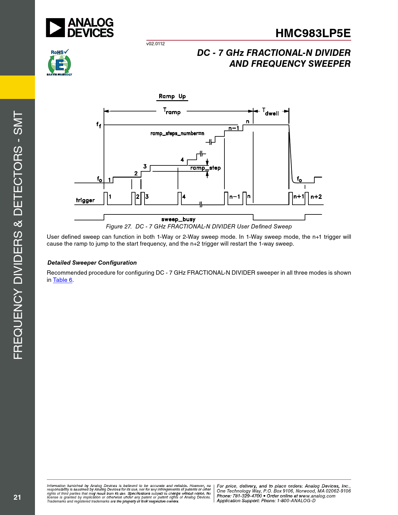

t M s s - r o t c e t e Figure 27. DC - 7 GHz FRACTIONAL-N DIVIDER User Defined Sweep s & D r user defined sweep can function in both 1-Way or 2-Way sweep mode. in 1-Way sweep mode, the n+1 trigger will e cause the ramp to jump to the start frequency, and the n+2 trigger will restart the 1-way sweep. iD
Detailed Sweeper Configuration
iv recommended procedure for configuring Dc - 7 GHz FrActionAL-n DiviDer sweeper in all three modes is shown in table 6. y D c n e u q e r F Inf F or o m r p atio r n ifc ur e n , d ishe e d lbiv y e A r n y a alog n D d t evic o p es is la beclie o eved rd to ebre sa: H ccur iattti e tae M nd re ilicarbloew . H a o ve C wever, o n rp o For price, delivery, and to place orders: Analog Devices, Inc., responsibility is assumed by Analog Devices for its use, nor for any infringements of patents or other oration, 2 Elizabeth Drive, Chelmsford, MA 01824 One Technology Way, P.O. Box 9106, Norwood, MA 02062-9106 Phone: 978-250-3343 Fax: 978-250-3373 O rights of third parties that may result from its use. Specifications subject to change without notice. No P rd ho e ne r O : 7 n 81- -3li 2n 9 e a -47 t w 0 w 0 • O w rd .h e it r o tniltie n .c e ao t m
