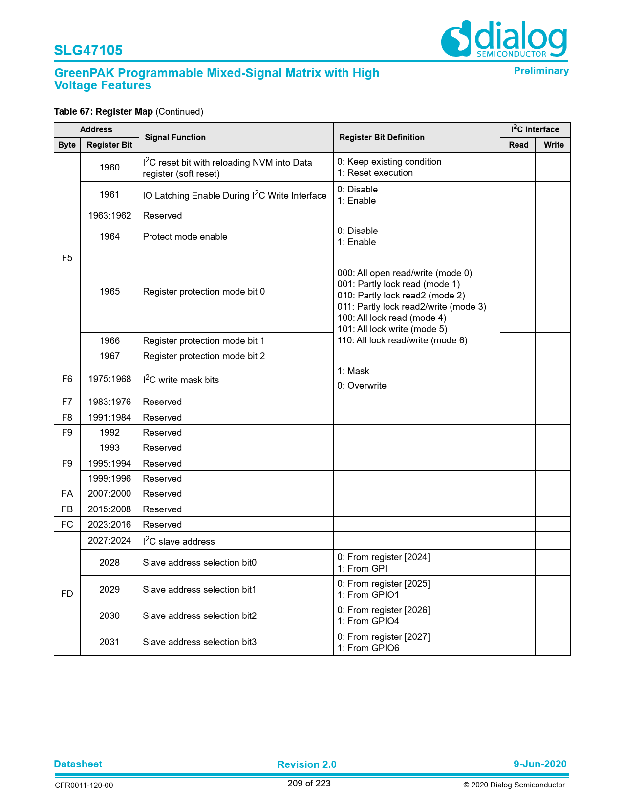

SLG47105 GreenPAK Programmable Mixed-Signal Matrix with High Preliminary Voltage Features Table 67: Register Map
(Continued)
Address I2C Interface Signal Function Register Bit Definition Byte Register Bit Read Write
I2C reset bit with reloading NVM into Data 0: Keep existing condition 1960 register (soft reset) 1: Reset execution 0: Disable 1961 IO Latching Enable During I2C Write Interface 1: Enable 1963:1962 Reserved 0: Disable 1964 Protect mode enable 1: Enable F5 000: All open read/write (mode 0) 001: Partly lock read (mode 1) 1965 Register protection mode bit 0 010: Partly lock read2 (mode 2) 011: Partly lock read2/write (mode 3) 100: All lock read (mode 4) 101: All lock write (mode 5) 1966 Register protection mode bit 1 110: All lock read/write (mode 6) 1967 Register protection mode bit 2 1: Mask F6 1975:1968 I2C write mask bits 0: Overwrite F7 1983:1976 Reserved F8 1991:1984 Reserved F9 1992 Reserved 1993 Reserved F9 1995:1994 Reserved 1999:1996 Reserved FA 2007:2000 Reserved FB 2015:2008 Reserved FC 2023:2016 Reserved 2027:2024 I2C slave address 0: From register [2024] 2028 Slave address selection bit0 1: From GPI 0: From register [2025] 2029 Slave address selection bit1 FD 1: From GPIO1 0: From register [2026] 2030 Slave address selection bit2 1: From GPIO4 0: From register [2027] 2031 Slave address selection bit3 1: From GPIO6
