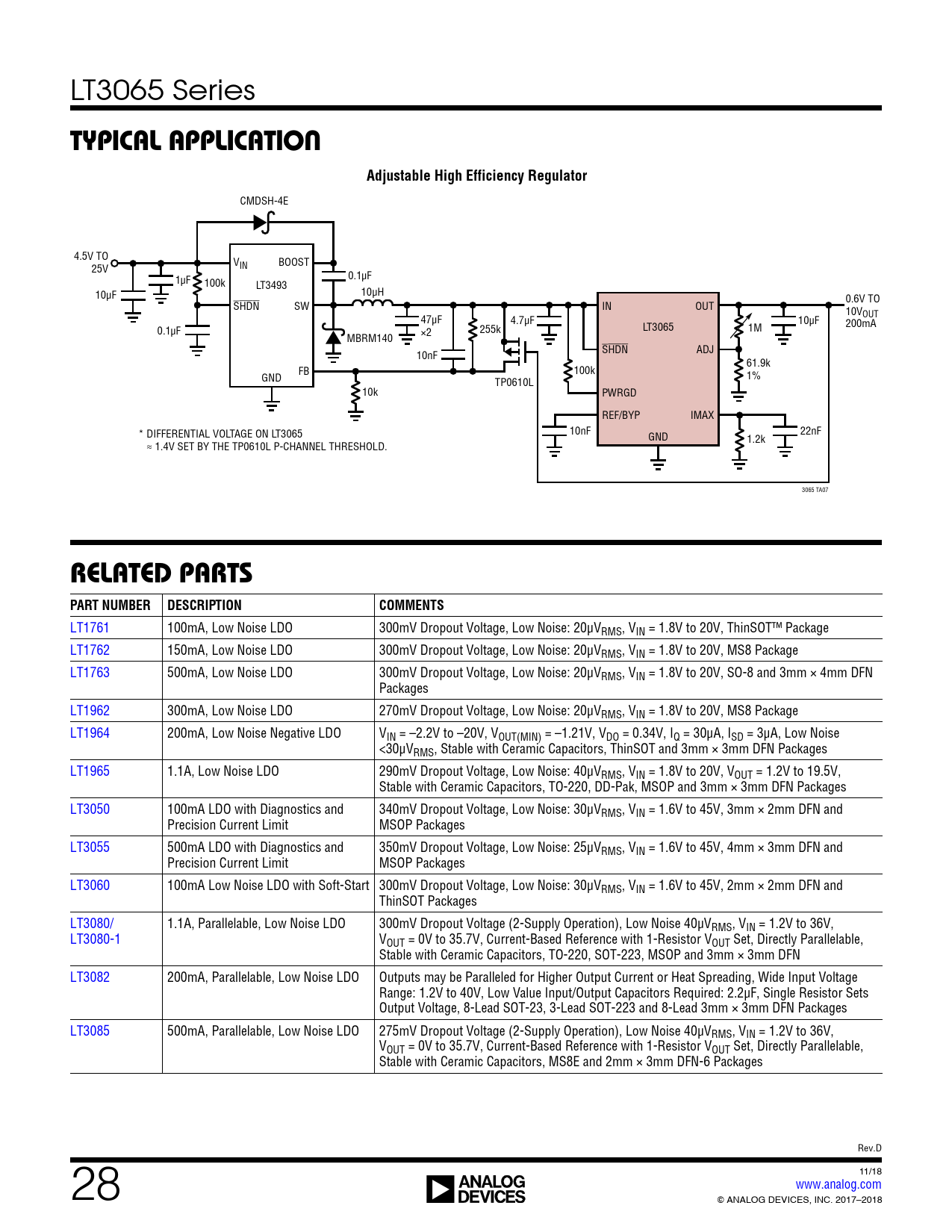

TYPICAL APPLICATION Adjustable High Efficiency Regulator
CMDSH-4E 4.5V TO VIN BOOST 25V 0.1µF 1µF 100k LT3493 10µH 10µF 0.6V TO SHDN SW IN OUT 10VOUT 47µF 4.7µF 0.1µF 255k LT3065 10µF 200mA ×2 1M MBRM140 SHDN ADJ 10nF 61.9k FB 100k GND 1% TP0610L 10k PWRGD REF/BYP IMAX * DIFFERENTIAL VOLTAGE ON LT3065 10nF GND 22nF 1.2k ≈ 1.4V SET BY THE TP0610L P-CHANNEL THRESHOLD. 3065 TA07
RELATED PARTS PART NUMBER DESCRIPTION COMMENTS
LT1761 100mA, Low Noise LDO 300mV Dropout Voltage, Low Noise: 20μVRMS, VIN = 1.8V to 20V, ThinSOT™ Package LT1762 150mA, Low Noise LDO 300mV Dropout Voltage, Low Noise: 20μVRMS, VIN = 1.8V to 20V, MS8 Package LT1763 500mA, Low Noise LDO 300mV Dropout Voltage, Low Noise: 20μVRMS, VIN = 1.8V to 20V, SO-8 and 3mm × 4mm DFN Packages LT1962 300mA, Low Noise LDO 270mV Dropout Voltage, Low Noise: 20μVRMS, VIN = 1.8V to 20V, MS8 Package LT1964 200mA, Low Noise Negative LDO VIN = –2.2V to –20V, VOUT(MIN) = –1.21V, VDO = 0.34V, IQ = 30μA, ISD = 3μA, Low Noise <30μVRMS, Stable with Ceramic Capacitors, ThinSOT and 3mm × 3mm DFN Packages LT1965 1.1A, Low Noise LDO 290mV Dropout Voltage, Low Noise: 40μVRMS, VIN = 1.8V to 20V, VOUT = 1.2V to 19.5V, Stable with Ceramic Capacitors, TO-220, DD-Pak, MSOP and 3mm × 3mm DFN Packages LT3050 100mA LDO with Diagnostics and 340mV Dropout Voltage, Low Noise: 30μVRMS, VIN = 1.6V to 45V, 3mm × 2mm DFN and Precision Current Limit MSOP Packages LT3055 500mA LDO with Diagnostics and 350mV Dropout Voltage, Low Noise: 25μVRMS, VIN = 1.6V to 45V, 4mm × 3mm DFN and Precision Current Limit MSOP Packages LT3060 100mA Low Noise LDO with Soft-Start 300mV Dropout Voltage, Low Noise: 30μVRMS, VIN = 1.6V to 45V, 2mm × 2mm DFN and ThinSOT Packages LT3080/ 1.1A, Parallelable, Low Noise LDO 300mV Dropout Voltage (2-Supply Operation), Low Noise 40µVRMS, VIN = 1.2V to 36V, LT3080-1 VOUT = 0V to 35.7V, Current-Based Reference with 1-Resistor VOUT Set, Directly Parallelable, Stable with Ceramic Capacitors, TO-220, SOT-223, MSOP and 3mm × 3mm DFN LT3082 200mA, Parallelable, Low Noise LDO Outputs may be Paralleled for Higher Output Current or Heat Spreading, Wide Input Voltage Range: 1.2V to 40V, Low Value Input/Output Capacitors Required: 2.2µF, Single Resistor Sets Output Voltage, 8-Lead SOT-23, 3-Lead SOT-223 and 8-Lead 3mm × 3mm DFN Packages LT3085 500mA, Parallelable, Low Noise LDO 275mV Dropout Voltage (2-Supply Operation), Low Noise 40µVRMS, VIN = 1.2V to 36V, VOUT = 0V to 35.7V, Current-Based Reference with 1-Resistor VOUT Set, Directly Parallelable, Stable with Ceramic Capacitors, MS8E and 2mm × 3mm DFN-6 Packages Rev.D 28 11/18 www.analog.com For more information www.analog.com ANALOG DEVICES, INC. 2017–2018 Document Outline Features Applications Description Typical Application Absolute Maximum Ratings Pin Configuration Order Information Electrical Characteristics Typical Performance Characteristics Block Diagram Applications Information Typical Applications Package Description Typical Application Related Parts
