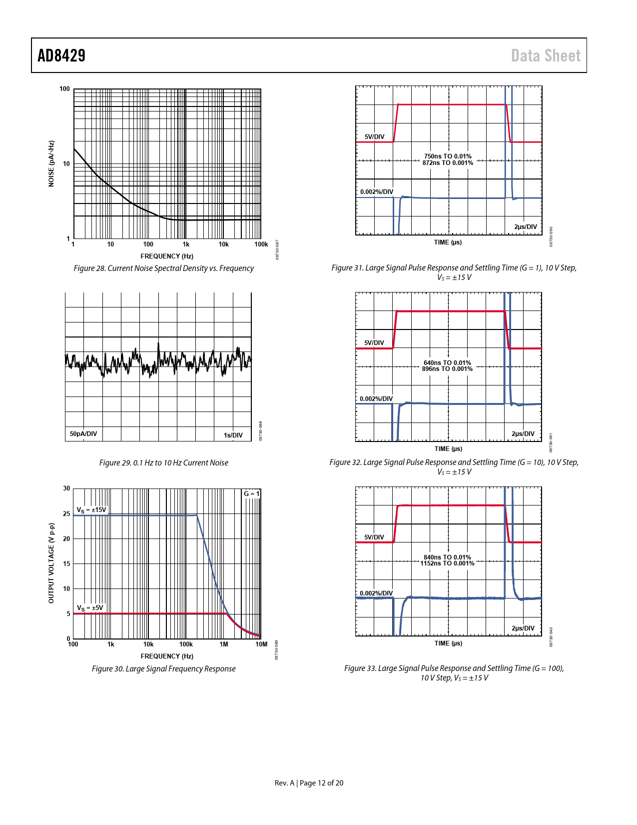

AD8429 Data Sheet 100 ) 5V/DIV √Hz A/ 750ns TO 0.01% p ( 10 872ns TO 0.001% E IS NO 0.002%/DIV 2µs/DIV
90 0
1
0-
1 10 100 1k 10k 100k TIME (µs)
73 087 09 30-
FREQUENCY (Hz)
097 Figure 28. Current Noise Spectral Density vs. Frequency Figure 31. Large Signal Pulse Response and Settling Time (G = 1), 10 V Step, VS = ±15 V
5V/DIV 640ns TO 0.01% 896ns TO 0.001% 0.002%/DIV
88 0
50pA/DIV
0-
1s/DIV
73
2µs/DIV
1 9 09 0 0-
TIME (µs)
73 09 Figure 29. 0.1 Hz to 10 Hz Current Noise Figure 32. Large Signal Pulse Response and Settling Time (G = 10), 10 V Step, VS = ±15 V
30 G = 1 V 25 S = ±15V ) -p p V 20 5V/DIV ( E AG T 840ns TO 0.01% L 15 1152ns TO 0.001% O V UT P 10 UT 0.002%/DIV O VS = ±5V 5 2µs/DIV
0 4 0
0
0-
100 1k 10k 100k 1M 10M
73 89
TIME (µs)
0 09 30-
FREQUENCY (Hz)
097 Figure 30. Large Signal Frequency Response Figure 33. Large Signal Pulse Response and Settling Time (G = 100), 10 V Step, VS = ±15 V Rev. A | Page 12 of 20 Document Outline FEATURES APPLICATIONS PIN CONNECTION DIAGRAM GENERAL DESCRIPTION REVISION HISTORY SPECIFICATIONS ABSOLUTE MAXIMUM RATINGS THERMAL RESISTANCE ESD CAUTION PIN CONFIGURATION AND FUNCTION DESCRIPTIONS TYPICAL PERFORMANCE CHARACTERISTICS THEORY OF OPERATION ARCHITECTURE RG Power Dissipation REFERENCE TERMINAL INPUT VOLTAGE RANGE LAYOUT Common-Mode Rejection Ratio over Frequency Power Supplies and Grounding Reference Pin INPUT BIAS CURRENT RETURN PATH INPUT PROTECTION Input Voltages Beyond the Rails Large Differential Input Voltage at High Gain IMAX RADIO FREQUENCY INTERFERENCE (RFI) CALCULATING THE NOISE OF THE INPUT STAGE Source Resistance Noise Voltage Noise of the Instrumentation Amplifier Current Noise of the Instrumentation Amplifier Total Noise Density Calculation OUTLINE DIMENSIONS ORDERING GUIDE
