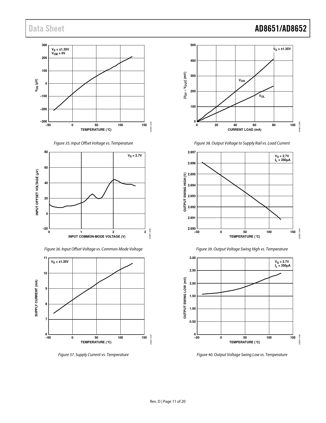

Страниц / Страница20 / 11 — Data Sheet. AD8651/AD8652. 300. 500. S = ±1.35V. VCM = 0V. 200. 400. 100. …

Data Sheet AD8651/AD8652 300 500 V V S = ±1.35V S = ±1.35V VCM = 0V 200 400 100 V) 300 ) (m V T OH (µV) 0 OUV OSV 200 –100 SY V (V OL 100 –200 –300 0

330 0 0 Figure 35. Input Offset Voltage vs. Temperature Figure 38. Output Voltage to Supply Rail vs. Load Current
80 2.697 VS = 2.7V VS = 2.7V IL = 250µA 2.696 60 V) ) V 2.695 E ( G A T 40 IGH L 2.694 O G H V IN ET W S 2.693 S F 20 T F U O T TP 2.692 U P OU IN 0 2.691 –20 2.690

33 0 0 Figure 36. Input Offset Voltage vs. Common-Mode Voltage Figure 39. Output Voltage Swing High vs. Temperature
11 3.00 VS = ±1.35V VS = 2.7V IL = 250µA 2.50 10 ) ) V A (m 2.00 (m 9 W NT G LO 1.50 IN URRE W C Y 8 S L T P U 1.00 UP TP S OU 7 0.50 6 0

33 0 0 Figure 37. Supply Current vs. Temperature Figure 40. Output Voltage Swing Low vs. Temperature Rev. D | Page 11 of 20 Document Outline Features Applications Pin Configurations General Description Table of Contents Revision History Specifications Electrical Characteristics Absolute Maximum Ratings ESD Caution Thermal Resistance Typical Performance Characteristics Applications Theory of Operation Rail-to-Rail Output Stage Rail-to-Rail Input Stage Input Protection Overdrive Recovery Layout, Grounding, and Bypassing Considerations Power Supply Bypassing Grounding Leakage Currents Input Capacitance Output Capacitance Settling Time THD Readings vs. Common-Mode Voltage Driving a 16-Bit ADC Outline Dimensions Ordering Guide
