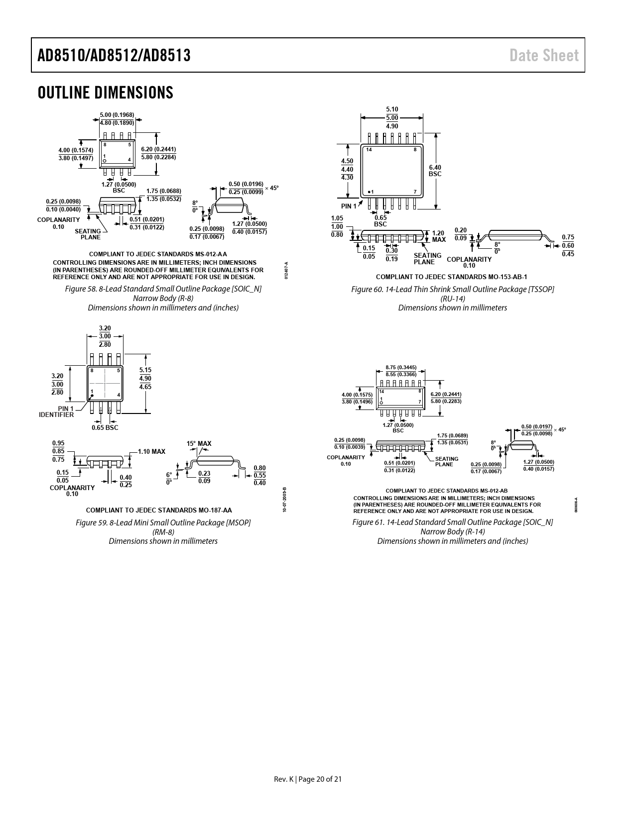

AD8510/AD8512/AD8513. Date Sheet. OUTLINE DIMENSIONS. 5.10. 5.00 (0.1968). 5.00. 4.80 (0.1890). 4.90. 4.00 (0.1574). 6.20 (0.2441)

AD8510/AD8512/AD8513 Date Sheet OUTLINE DIMENSIONS 5.10 5.00 (0.1968) 5.00 4.80 (0.1890) 4.90 8 5 4.00 (0.1574) 6.20 (0.2441) 14 8 1 3.80 (0.1497) 4 5.80 (0.2284) 4.50 4.40 6.40 BSC 4.30 1.27 (0.0500) 0.50 (0.0196) 45° BSC 1.75 (0.0688) 0.25 (0.0099) 1 7 1.35 (0.0532) 0.25 (0.0098) 0.10 (0.0040) PIN 1 COPLANARITY 0.51 (0.0201) 1.05 0.65 1.27 (0.0500) 0.10 0.31 (0.0122) BSC 0.25 (0.0098) 1.00 SEATING 0.40 (0.0157) 1.20 0.20 PLANE 0.17 (0.0067) 0.80 MAX 0.09 0.75 0.15 0.60 0.30 COMPLIANT TO JEDEC STANDARDS MS-012-AA 0.05 SEATING 0.45 0.19 COPLANARITY CONTROLLING DIMENSIONS ARE IN MILLIMETERS; INCH DIMENSIONS A PLANE 0.10 (IN PARENTHESES) ARE ROUNDED-OFF MILLIMETER EQUIVALENTS FOR 07- REFERENCE ONLY AND ARE NOT APPROPRIATE FOR USE IN DESIGN. 0124 COMPLIANT TO JEDEC STANDARDS MO-153-AB-1
Figure 58. 8-Lead Standard Small Outline Package [SOIC_N] Figure 60. 14-Lead Thin Shrink Small Outline Package [TSSOP] Narrow Body (R-8) (RU-14) Dimensions shown in millimeters and (inches) Dimensions shown in millimeters
3.20 3.00 2.80 8.75 (0.3445) 8 5 5.15 3.20 8.55 (0.3366) 4.90 3.00 4.65 1 2.80 14 8 4 4.00 (0.1575) 6.20 (0.2441) 1 3.80 (0.1496) 7 5.80 (0.2283) PIN 1 IDENTIFIER 0.65 BSC 1.27 (0.0500) 0.50 (0.0197) BSC 45° 1.75 (0.0689) 0.25 (0.0098) 0.95 0.25 (0.0098) 15° MAX 1.35 (0.0531) 0.10 (0.0039) 0.85 1.10 MAX 0.75 COPLANARITY SEATING 0.10 0.51 (0.0201) PLANE 1.27 (0.0500) 0.25 (0.0098) 0.80 0.40 (0.0157) 0.15 0.31 (0.0122) 0.17 (0.0067) 0.23 0.55 0.40 0.05 0.09 0.40 0.25 COPLANARITY -B 0.10 COMPLIANT TO JEDEC STANDARDS MS-012-AB 2009 CONTROLLING DIMENSIONS ARE IN MILLIMETERS; INCH DIMENSIONS A 6- 07- (IN PARENTHESES) ARE ROUNDED-OFF MILLIMETER EQUIVALENTS FOR COMPLIANT TO JEDEC STANDARDS MO-187-AA 10- REFERENCE ONLY AND ARE NOT APPROPRIATE FOR USE IN DESIGN. 06060
Figure 59. 8-Lead Mini Small Outline Package [MSOP] Figure 61. 14-Lead Standard Small Outline Package [SOIC_N] (RM-8) Narrow Body (R-14) Dimensions shown in millimeters Dimensions shown in millimeters and (inches) Rev. K | Page 20 of 21 Document Outline FEATURES APPLICATIONS PIN CONFIGURATIONS GENERAL DESCRIPTION TABLE OF CONTENTS REVISION HISTORY SPECIFICATIONS ELECTRICAL CHARACTERISTICS ABSOLUTE MAXIMUM RATINGS ESD CAUTION TYPICAL PERFORMANCE CHARACTERISTICS GENERAL APPLICATION INFORMATION INPUT OVERVOLTAGE PROTECTION OUTPUT PHASE REVERSAL TOTAL HARMONIC DISTORTION (THD) + NOISE TOTAL NOISE INCLUDING SOURCE RESISTORS SETTLING TIME OVERLOAD RECOVERY TIME CAPACITIVE LOAD DRIVE OPEN-LOOP GAIN AND PHASE RESPONSE PRECISION RECTIFIERS I-V CONVERSION APPLICATIONS Photodiode Circuits Signal Transmission Applications Crosstalk OUTLINE DIMENSIONS ORDERING GUIDE
