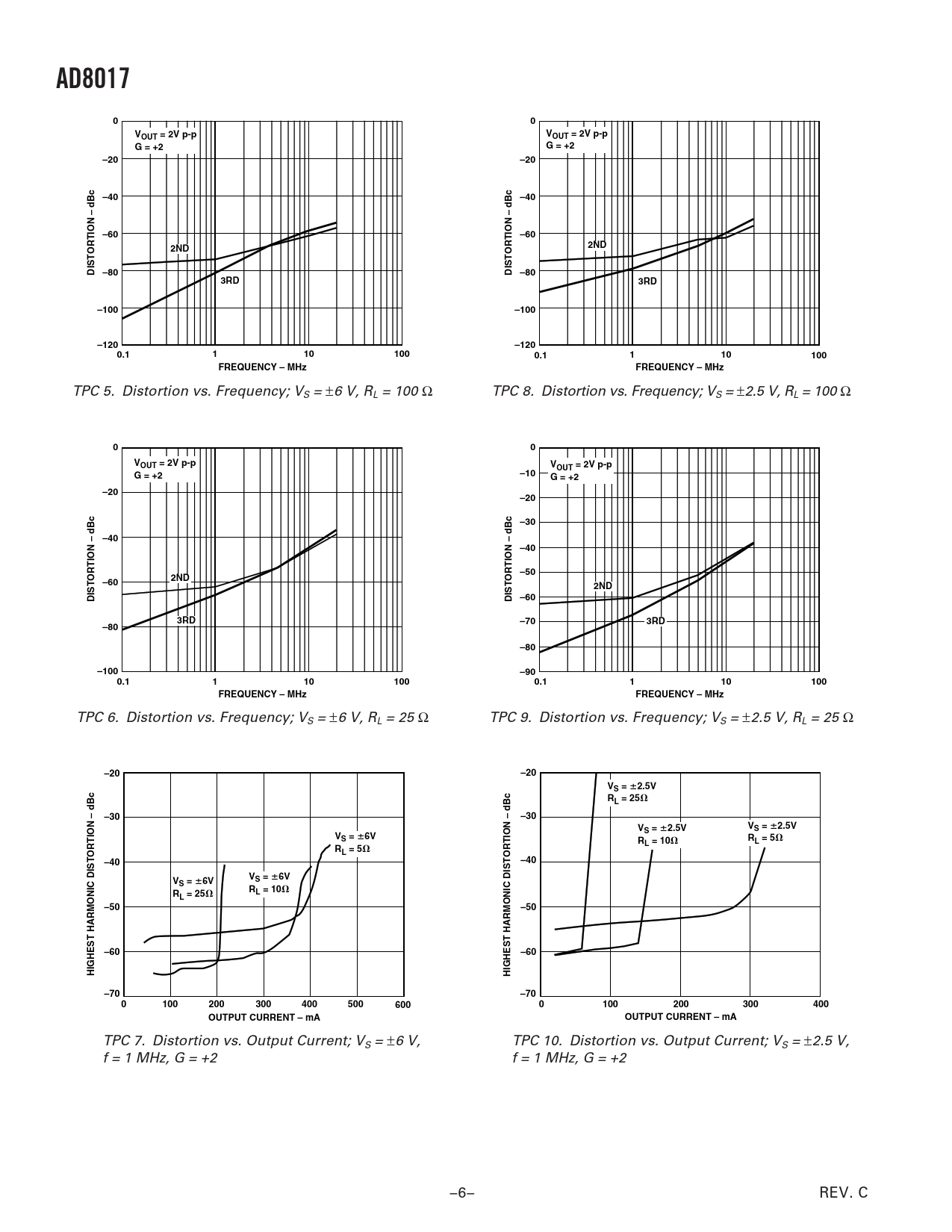

AD8017 0 0 V V OUT = 2V p-p OUT = 2V p-p G = +2 G = +2 –20 –20 –40 –40 dBc dBc –60 –60 2ND 2ND DISTORTION –80 DISTORTION –80 3RD 3RD –100 –100 –120 –120 0.1 1 10 100 0.1 1 10 100 FREQUENCY – MHz FREQUENCY – MHz
TPC 5. Distortion vs. Frequency; VS = ±6 V, RL = 100 Ω TPC 8. Distortion vs. Frequency; VS = ±2.5 V, RL = 100 Ω
0 0 VOUT = 2V p-p VOUT = 2V p-p G = +2 –10 G = +2 –20 –20 –30 dBc dBc – –40 –40 –50 –60 2ND 2ND DISTORTION DISTORTION –60 3RD –70 3RD –80 –80 –100 –90 0.1 1 10 100 0.1 1 10 100 FREQUENCY – MHz FREQUENCY – MHz
TPC 6. Distortion vs. Frequency; VS = ±6 V, RL = 25 Ω TPC 9. Distortion vs. Frequency; VS = ±2.5 V, RL = 25 Ω

–50 –50 –60 –60 HIGHEST HARMONIC DISTORTION HIGHEST HARMONIC DISTORTION –70 –70 0 100 200 300 400 500 600 0 100 200 300 400 OUTPUT CURRENT – mA OUTPUT CURRENT – mA
