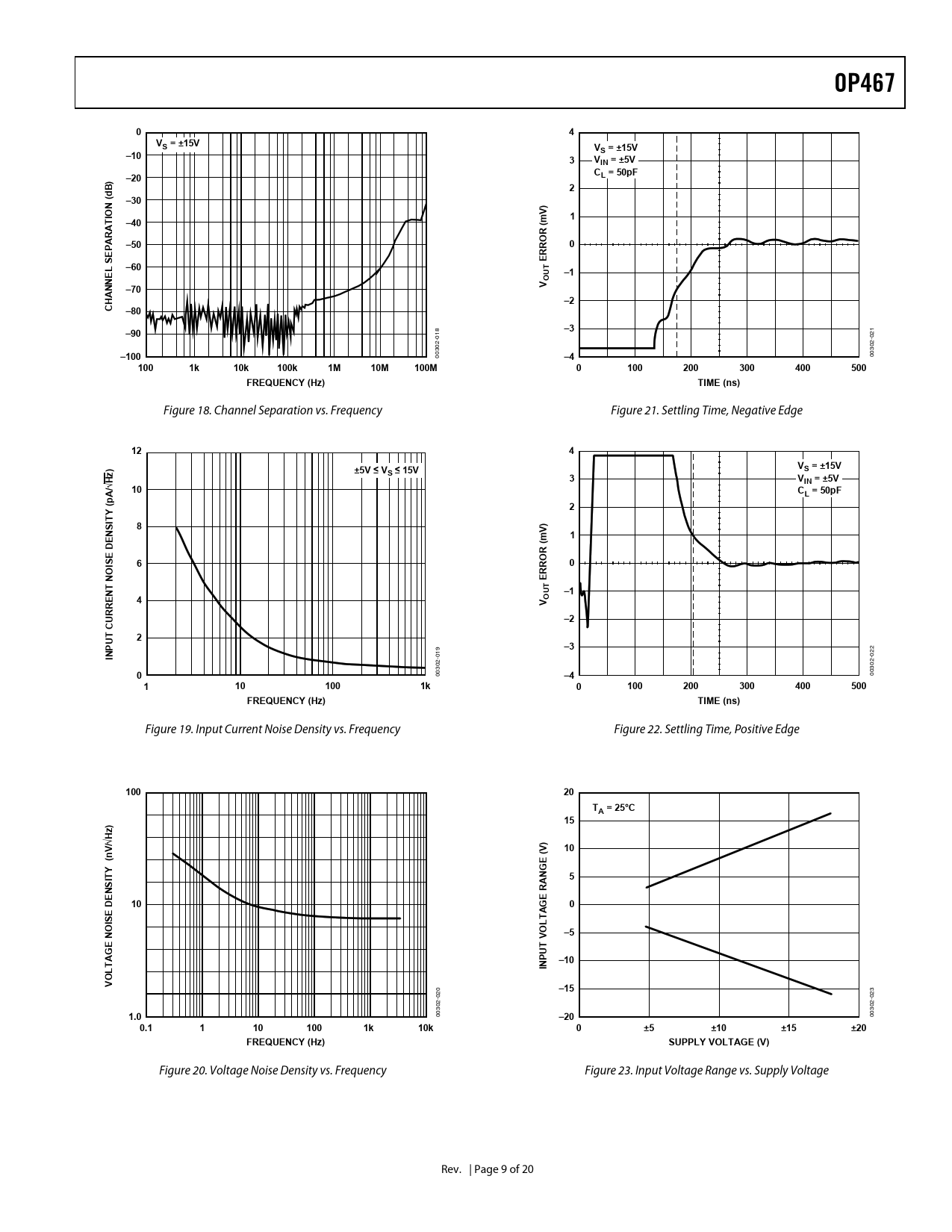

OP467 0 4 VS = ±15V VS = ±15V –10 3 VIN = ±5V C –20 L = 50pF ) B 2 (d –30 N IO V) 1 –40 (m RAT R A O –50 P R 0 E S ER L –60 T –1 NE OUV –70 –2 CHAN –80 –3 –90
8 21 01 0 2- 2- 30 30
–100
00
–4
00
100 1k 10k 100k 1M 10M 100M 0 100 200 300 400 500 FREQUENCY (Hz) TIME (ns)
Figure 18. Channel Separation vs. Frequency Figure 21. Settling Time, Negative Edge
12 4 ) ±5V ≤ V V S ≤ 15V S = ±15V 3 V √Hz IN = ±5V 10 A/ CL = 50pF (p 2 Y IT 8 NS V) E 1 (m D R E O IS 6 R 0 NO ER T T N –1 4 OUV URRE –2 C 2 UT P
9
–3
22
IN
01 0 2- 2- 30 30
0
00
–4
00
1 10 100 1k 0 100 200 300 400 500 FREQUENCY (Hz) TIME (ns)
Figure 19. Input Current Noise Density vs. Frequency Figure 22. Settling Time, Positive Edge
100 20 TA = 25°C ) 15 √Hz ) V/ V 10 (n ( E Y IT 5 S N RANG E E 10 D 0 E AG T IS L O O –5 V E N G UT A T –10 L INP O V –15
20 23 0 0 2- 2- 30 30
1.0
00
–20
00
0.1 1 10 100 1k 10k 0 ±5 ±10 ±15 ±20 FREQUENCY (Hz) SUPPLY VOLTAGE (V)
Figure 20. Voltage Noise Density vs. Frequency Figure 23. Input Voltage Range vs. Supply Voltage Rev. * | Page 9 of 20 Document Outline FEATURES APPLICATIONS GENERAL DESCRIPTION PIN CONFIGURATIONS TABLE OF CONTENTS REVISION HISTORY SPECIFICATIONS ELECTRICAL CHARACTERISTICS WAFER TEST LIMITS ABSOLUTE MAXIMUM RATINGS THERMAL RESISTANCE DICE CHARACTERISTICS ESD CAUTION TYPICAL PERFORMANCE CHARACTERISTICS APPLICATIONS INFORMATION OUTPUT SHORT-CIRCUIT PERFORMANCE UNUSED AMPLIFIERS PCB LAYOUT CONSIDERATIONS GROUNDING POWER SUPPLY CONSIDERATIONS SIGNAL CONSIDERATIONS PHASE REVERSAL SATURATION RECOVERY TIME HIGH SPEED INSTRUMENTATION AMPLIFIER 2 MHz BIQUAD BAND-PASS FILTER FAST I-TO-V CONVERTER OP467 SPICE MARCO-MODEL OUTLINE DIMENSIONS ORDERING GUIDE
