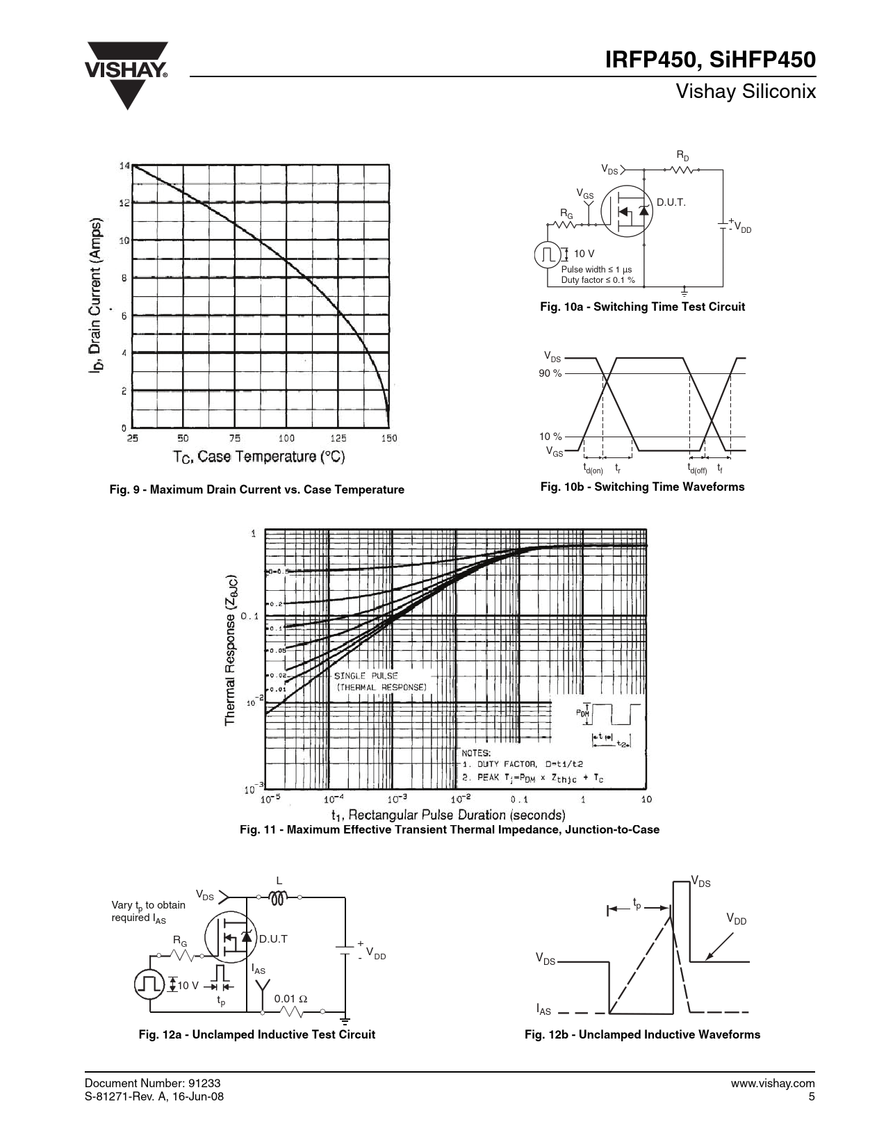

IRFP450, SiHFP450. Fig. 10a - Switching Time Test Circuit. Fig. 9 - Maximum Drain Current vs. Case Temperature
IRFP450, SiHFP450 Fig 10a - Switching Time Test Circuit Fig 9 - Maximum Drain Current vs Case Temperature

IRFP450, SiHFP450
Vishay Siliconix RD VDS VGS D.U.T. RG + - VDD 10 V Pulse width ≤ 1 µs Duty factor ≤ 0.1 %
VDS 90 % 10 % VGS t t t t d(on) r d(off) f
Fig. 9 - Maximum Drain Current vs. Case Temperature Fig. 10b - Switching Time Waveforms Fig. 11 - Maximum Effective Transient Thermal Impedance, Junction-to-Case
L VDS VDS Vary t t p to obtain p required IAS VDD R D.U.T G + V - DD VDS I A AS 10 V t 0.01 p Ω IAS
Fig. 12a - Unclamped Inductive Test Circuit Fig. 12b - Unclamped Inductive Waveforms
