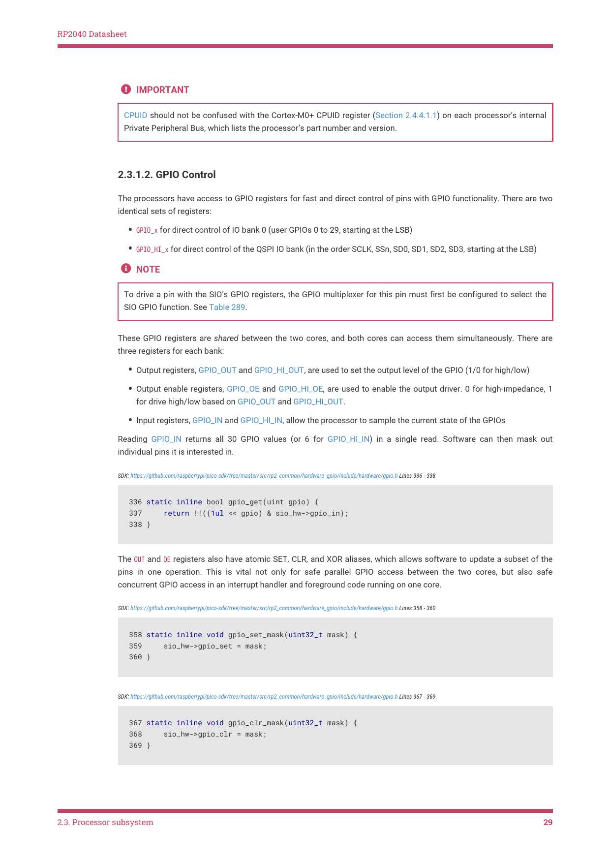

IMPORTANT
CPUID should not be confused with the Cortex-M0+ CPUID register (Section 2.4.4.1.1) on each processor’s internal Private Peripheral Bus, which lists the processor’s part number and version.
2.3.1.2. GPIO Control
The processors have access to GPIO registers for fast and direct control of pins with GPIO functionality. There are two identical sets of registers: • GPIO_x for direct control of IO bank 0 (user GPIOs 0 to 29, starting at the LSB) • GPIO_HI_x for direct control of the QSPI IO bank (in the order SCLK, SSn, SD0, SD1, SD2, SD3, starting at the LSB) 
NOTE
To drive a pin with the SIO’s GPIO registers, the GPIO multiplexer for this pin must first be configured to select the SIO GPIO function. See Table 289. These GPIO registers are shared between the two cores, and both cores can access them simultaneously. There are three registers for each bank: • Output registers, GPIO_OUT and GPIO_HI_OUT, are used to set the output level of the GPIO (1/0 for high/low) • Output enable registers, GPIO_OE and GPIO_HI_OE, are used to enable the output driver. 0 for high-impedance, 1 for drive high/low based on GPIO_OUT and GPIO_HI_OUT. • Input registers, GPIO_IN and GPIO_HI_IN, allow the processor to sample the current state of the GPIOs Reading GPIO_IN returns all 30 GPIO values (or 6 for GPIO_HI_IN) in a single read. Software can then mask out individual pins it is interested in. SDK: https://github.com/raspberrypi/pico-sdk/tree/master/src/rp2_common/hardware_gpio/include/hardware/gpio.h Lines 336 - 338 336 static inline bool gpio_get(uint gpio) { 337 return !!((1ul << gpio) & sio_hw->gpio_in); 338 } The OUT and OE registers also have atomic SET, CLR, and XOR aliases, which allows software to update a subset of the pins in one operation. This is vital not only for safe parallel GPIO access between the two cores, but also safe concurrent GPIO access in an interrupt handler and foreground code running on one core. SDK: https://github.com/raspberrypi/pico-sdk/tree/master/src/rp2_common/hardware_gpio/include/hardware/gpio.h Lines 358 - 360 358 static inline void gpio_set_mask(uint32_t mask) { 359 sio_hw->gpio_set = mask; 360 } SDK: https://github.com/raspberrypi/pico-sdk/tree/master/src/rp2_common/hardware_gpio/include/hardware/gpio.h Lines 367 - 369 367 static inline void gpio_clr_mask(uint32_t mask) { 368 sio_hw->gpio_clr = mask; 369 } 2.3. Processor subsystem
