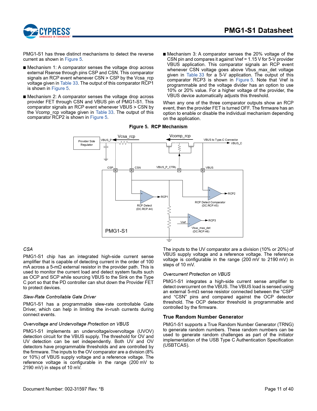

PMG1-S1 has three distinct mechanisms to detect the reverse ■ Mechanism 3: A comparator senses the 20% voltage of the current as shown in Figure 5. CSN pin and compares it against Vref = 1.15 V for 5-V provider VBUS application. This comparator signals an RCP event ■ Mechanism 1: A comparator senses the voltage drop across whenever CSN voltage goes above Vbus_max_det voltage external Rsense through pins CSP and CSN. This comparator given in Table 33 for a 5-V application. The output of this signals an RCP event whenever CSN > CSP by the Vcsa_rcp comparator RCP3 is shown in Figure 5. Note that Vref is voltage given in Table 33. The output of this comparator RCP1 programmable and the voltage divider has an option to use is shown in Figure 5. 10% or 20% value. For a higher voltage of the provider, the ■ Mechanism 2: A comparator senses the voltage drop across VBUS device automatically adjusts this threshold. provider FET through CSN and VBUS pin of PMG1-S1. This When any one of the three comparator outputs show an RCP comparator signals an RCP event whenever VBUS > CSN by event, then the provider FET is turned OFF. The firmware has an the Vcomp_rcp voltage given in Table 33. The output of this option to enable or disable the individual mechanism depending comparator RCP2 is shown in Figure 5. on the application.
Figure 5. RCP Mechanism
Vcsa_rcp Vcomp_rcp VBUS_P VBUS to Type-C Connector Provider Side Regulator VBUS_C CSP VBUS_P_CTRL CSN VBUS RCP2 RCP1 RCP Detect Comparator RCP Detect (DC.RCP.45) (DC.RCP.44) RCP3 Vref Vbux_max_det PMG1-S1 (DC.RCP.46) CSA The inputs to the UV comparator are a division (10% or 20%) of PMG1-S1 chip has an integrated high-side current sense VBUS supply voltage and a reference voltage. The reference amplifier that is capable of detecting current in the order of 100 voltage is configurable in the range (200 mV to 2190 mV) in mA across a 5-mΩ external resistor in the provider path. This is steps of 10 mV. used to monitor the current load and detect system faults such Overcurrent Protection on VBUS as OCP and SCP while sourcing VBUS to the Sink on the Type C port so that the PD controller can shut down the Provider FET PMG1-S1 integrates a high-side current sense amplifier to to protect devices. detect overcurrent on the VBUS. The VBUS load is sensed using an external 5-m sense resistor connected between the “CSP” Slew-Rate Controllable Gate Driver and “CSN” pins and compared against the OCP detector PMG1-S1 has a programmable slew-rate controllable Gate threshold. The OCP detector threshold is programmable and Driver, which can help in limiting the in-rush currents during controlled by the firmware. connect events.
