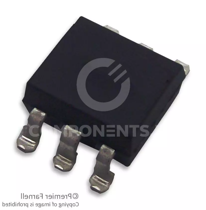

Optocoupler, Phototriac Output, Non-Zero Crossing FEATURES
• ITRMS = 300 mA • High static dV/dt < 10 000 V/μs • Electrically insulated between input and output A 1 6 MT2 circuit • Microcomputer compatible - very low trigger C 2 5 NC current • Trigger current NC 3 4 MT1 - (IFT < 1.2 mA) BRT12
F
- (IFT < 2 mA) BRT11
H
, BRT12
H
, BRT13
H
- (IFT < 3 mA) BRT12
M
, BRT13
M
• Non-zero voltage detectors high input sensitivity 23128 • Material categorization: for definitions of compliance please see www.vishay.com/doc?99912
