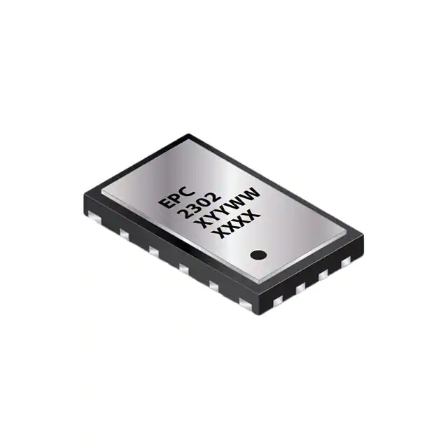

The EPC2302 is a 1.8 mΩ max RDS(on), 100 V eGaN® power transistor in a low inductance 3 x 5 mm QFN package with exposed top for excel ent thermal management. It is tailored to high frequency DC-DC
EPC2302
applications to/from 40 V–60 V and 48 V BLDC motor drives.
XYYWW XXXX
The thermal resistance to case top is ~0.2 °C/W, resulting in excel ent thermal behavior and easy cooling. The device features an enhanced PQFN “Thermal-Max” package. The exposed top enhances
EPC2302
top-side thermal management and the side-wettable flanks guarantee that the complete side-pad Package size: 3 x 5 mm surface is wetted with solder during the reflow soldering process, which protects the copper and al ows soldering to occur on this external flank area for easy optical inspection.
