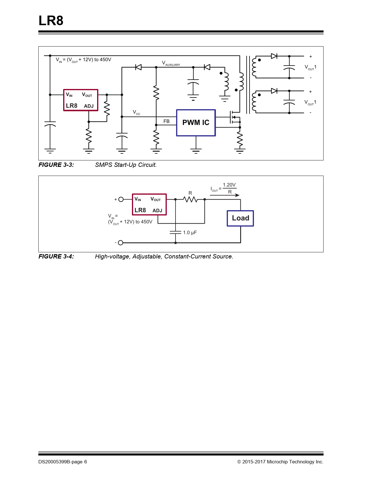

LR8
VIN = (VOUT + 12V) to 450V + VAUXILIARY VOUT1
-VIN LR8 + VOUT VOUT1 ADJ VCC FB FIGURE 3-3: PWM IC SMPS Start-Up Circuit. R
+ VIN LR8 IOUT = 1.20V
R VOUT VIN =
(VOUT + 12V) to 450V ADJ Load
1.0μF -FIGURE 3-4: DS20005399B-page 6 High-voltage, Adjustable, Constant-Current Source.  2015-2017 Microchip Technology Inc.
