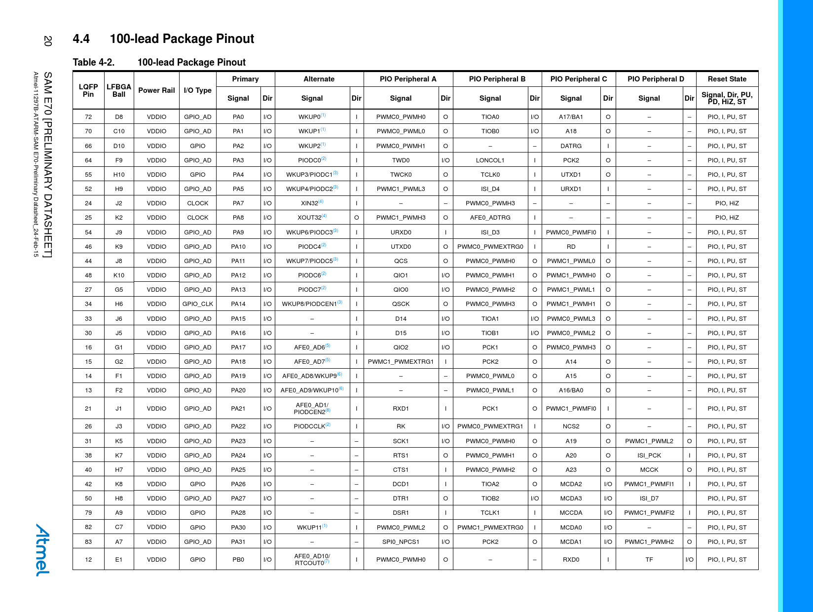

4.4. 100-lead Package Pinout. Table 4-2. Primary. Alternate. PIO Peripheral A. PIO Peripheral B. PIO Peripheral C. PIO Peripheral D
4.4 100-lead Package Pinout Table 4-2 Primary Alternate PIO Peripheral A PIO Peripheral B PIO Peripheral C PIO Peripheral D
Текстовая версия документа
link to page 23 link to page 23 link to page 23 link to page 23 link to page 23 link to page 23 link to page 23 link to page 23 link to page 23 link to page 23 link to page 23 link to page 23 link to page 23 link to page 23 link to page 23 link to page 23 link to page 23 link to page 23 link to page 23 link to page 23 link to page 23 link to page 18 20
4.4 100-lead Package Pinout Table 4-2. 100-lead Package Pinout
A SAM tm e
Primary Alternate PIO Peripheral A PIO Peripheral B PIO Peripheral C PIO Peripheral D Reset State
l-112
LQFP LFBGA
E70 [PRELIMINARY DATASHEET]
Power Rail I/O Type Pin Ball Signal, Dir, PU,
97
Signal Dir Signal Dir Signal Dir Signal Dir Signal Dir Signal Dir
B-
PD, HiZ, ST
