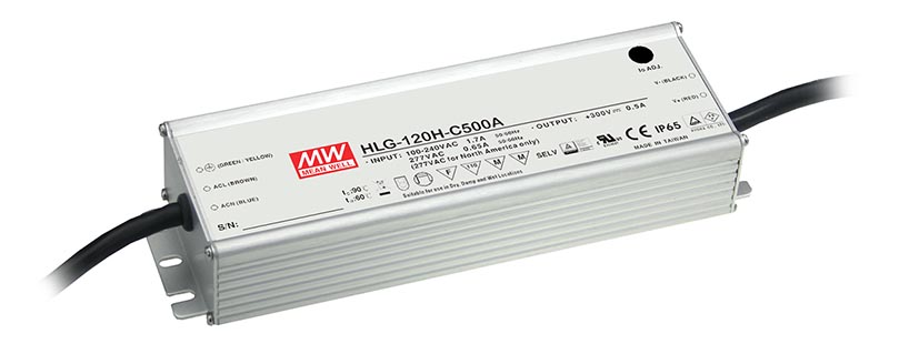

Mean Well - HLG-120H

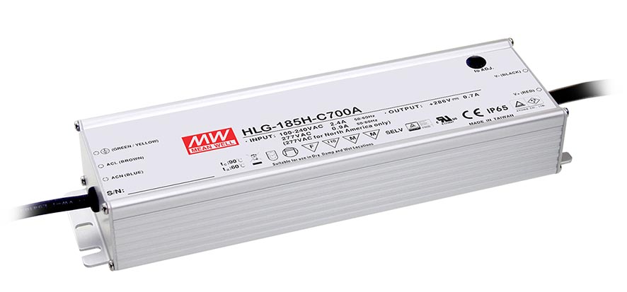

Mean Well - HLG-185H

HLG-120H
-C350A
HLG-120H
-C500A
HLG-120H
-C700A
HLG-120H
-C1050A
HLG-120H
-C1400A
HLG-185H
-C500A
HLG-185H
-C700A
HLG-185H
-C1050A
HLG-185H
-C1400A
