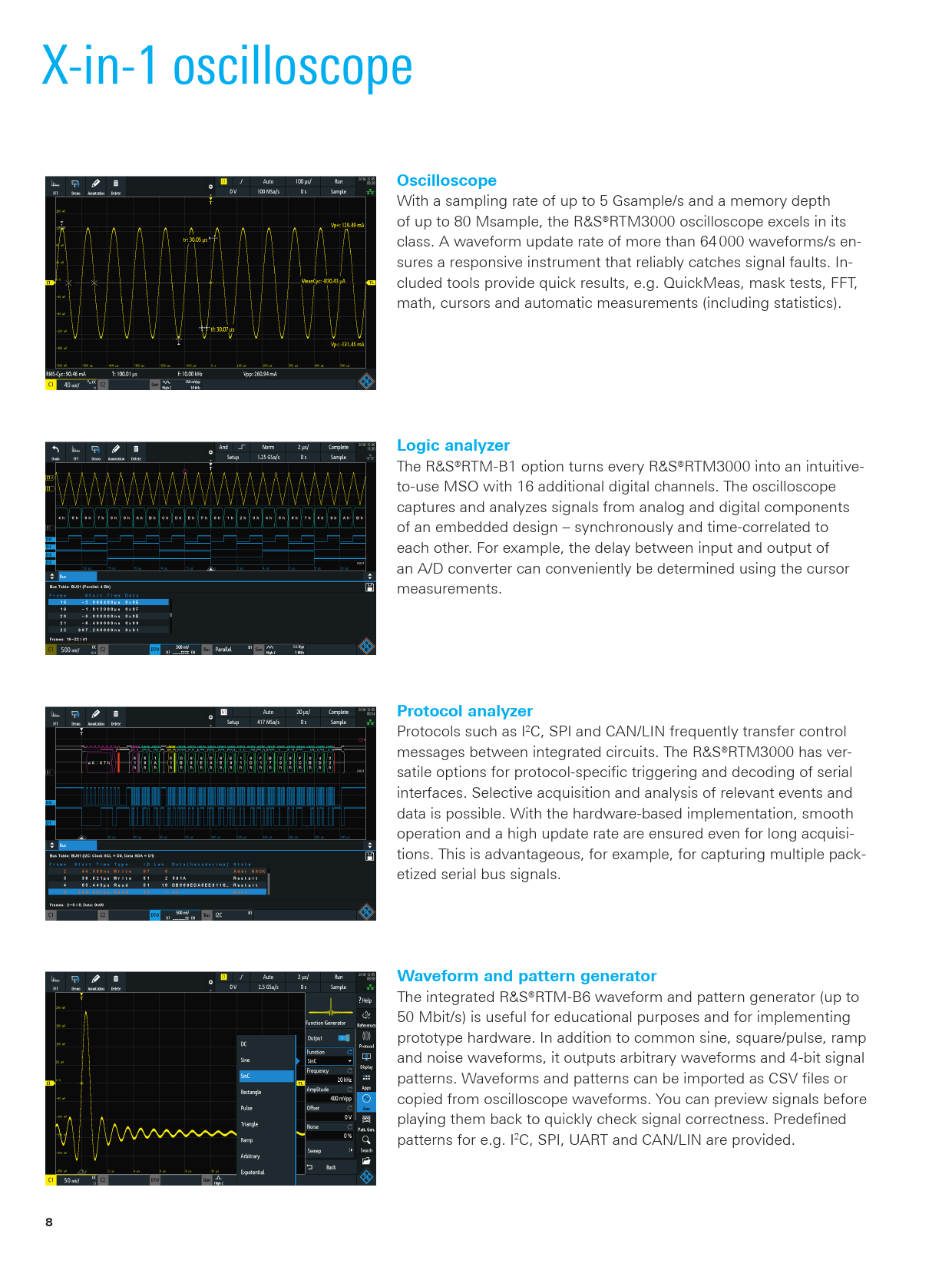

X-in-1 oscilloscope
Oscilloscope
With a sampling rate of up to 5 Gsample/s and a memory depth of up to 80 Msample, the R&S®RTM3000 oscilloscope excels in its class. A waveform update rate of more than 64 000 waveforms/s en- sures a responsive instrument that reliably catches signal faults. In- cluded tools provide quick results, e.g. QuickMeas, mask tests, FFT, math, cursors and automatic measurements (including statistics).
Logic analyzer
The R&S®RTM-B1 option turns every R&S®RTM3000 into an intuitive- to-use MSO with 16 additional digital channels. The oscilloscope captures and analyzes signals from analog and digital components of an embedded design – synchronously and time-correlated to each other. For example, the delay between input and output of an A/D converter can conveniently be determined using the cursor measurements.
Protocol analyzer
Protocols such as I2C, SPI and CAN/LIN frequently transfer control messages between integrated circuits. The R&S®RTM3000 has ver- satile options for protocol-specific triggering and decoding of serial interfaces. Selective acquisition and analysis of relevant events and data is possible. With the hardware-based implementation, smooth operation and a high update rate are ensured even for long acquisi- tions. This is advantageous, for example, for capturing multiple pack- etized serial bus signals.
Waveform and pattern generator
The integrated R&S®RTM-B6 waveform and pattern generator (up to 50 Mbit/s) is useful for educational purposes and for implementing prototype hardware. In addition to common sine, square/pulse, ramp and noise waveforms, it outputs arbitrary waveforms and 4-bit signal patterns. Waveforms and patterns can be imported as CSV files or copied from oscilloscope waveforms. You can preview signals before playing them back to quickly check signal correctness. Predefined patterns for e.g. I2C, SPI, UART and CAN/LIN are provided.
