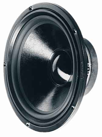

Динамик НЧ Visaton W 300 S/4

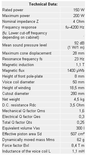

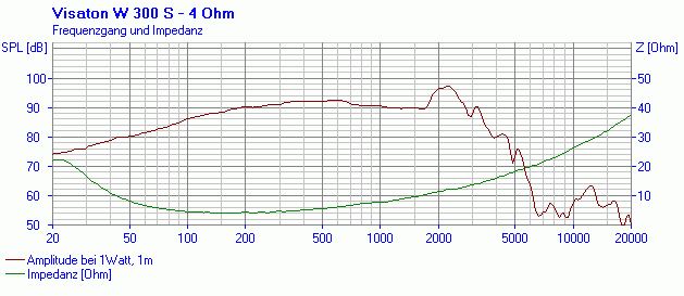

30 cm (12") HiFi woofer with powerful drive, extended rear pole plate and long stroke surround.

50 mm voice-coil for high power handling. Very suitable for large 3-way and 4-way combinations and for high power handling subwoofers.
